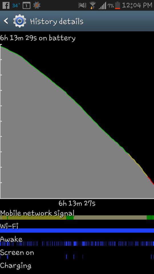

Help Battery went from full charge to 8% in 6 hours... wtf?
meissen
Seriously?
Something is keeping your phone awake, you might what to try removing any recent applications you installed prior to this.
Your wifi was also on the whole time, so I would guess it's an app that needs to sync or access the internet.
If this after a firmware update you might need a factory reset, firmware updates don't always go smoothly.
Can we see the other battery screen? so we can see what apps have been active?
Looks like you have a wakelock issue there.
What does your usage screen indicate?
That's what's REALLY weird -- I have wifi turned off... I noticed that it showed as if Wifi was on which is really confusing to me.
I haven't done any firmware upgrades in the past week, nor any app downloads either. All weekend it worked perfectly fine without any battery issues -- left it unplugged quite a bit without the battery draining this quickly.
Sacrificing having another app running constantly, is there any apps out there that will give you historical summary of what apps were causing the phone to be awake?
Looking at the screenshot it clearly shows Wifi is on in the top signal icon so I must have forgotten to turn it off over the weekend -- but still, it shouldn't have gone down this quick in 6 hours.

Whoa android system is out of control.
