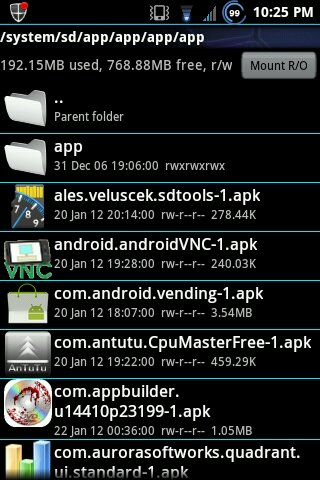

I have been doing a lot of testing lately, so I've doing a lot of restoring and backing up. This last time I did a restore everything went fine, but when I went to /system/sd, I noticed the app, app-private and all that, but here is my question, in each of those folders there is an identical folder. Like if I go into /system/sd/app, there will be all my apps as well as a folder named app, and when I enter that folder it the same thing as the prior directory. Is that normal or did I screw something up somewhere?
That and I moved my apps and dalvik to sd and it shows that it's on my card, but there is also a dalvik- cache, app, and app-private with files in them in my /data/ directory. Are they just links to the ones on my sd?
yes the folders in /data are just links to the sd card. the system does not see that though and that is why your phone can use them.
If you are in /data look at the free and used memory and then go into the /app then see how those numbers changed. your actually in the sd card at that point.
as far as your extra folders in /app that is a new one to me never seen that before.

The extra folders are on my ext partition. If I go through /system/sd/ there are the normal app, app-private folders and so on. Its when I open one of those folders where I find the extras and when I open /system/sd/app there is a list of my apps, but at the top of the list there is a folder called app its like going further down the rabbit hole, lol.

So I went and opened a few of the app folders on my ext4 a2sd partition and all the folders even app-private, dalvik-cache, and all are like this:
Notice the Directory at the top. I hope this give a better idea of my question. Thanks in advance!:D
