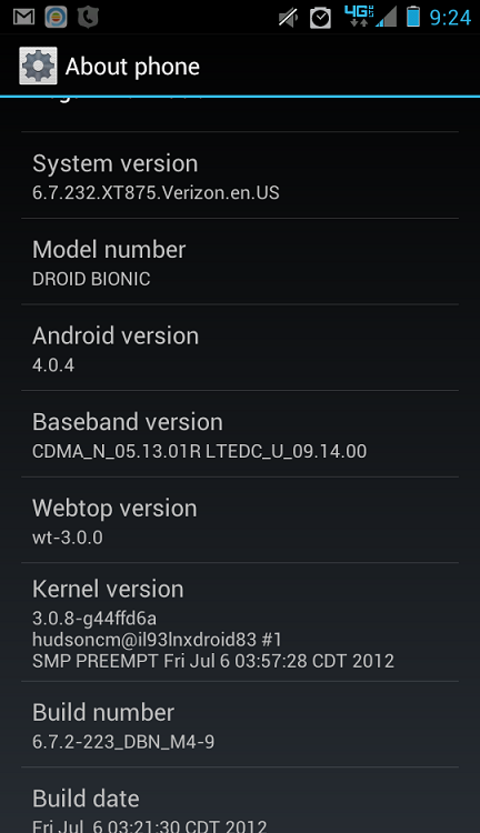

what os are you running? 5.9.905 or an ics leak?
I thought I was running an ICS leak that I obtained from another thread here. I attached a thumbnail so you can see.
That's ICS leak .232 after looking at your screenshot.
