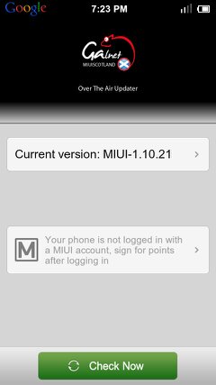

i need help with motorola droid verison. i have upgraded my os. and totally messed up my phone..
i have include some screen shots. looks like it work
anyway, i have istalled version: miui-1.10.21
phone works with this os. data and wifi wont work
no matter what installed each time reboot the phone it wipes everything apps etc. start as fresh installed OS on it. i have go thru the intial settings. this is each time reboot the phone.
so i am giving up now.
it will be so helpful if someone can help me to installed stock version on this phone. can't take it anymore.
i can't boot it to recovery mode so i can install stock OS on it. i don't care i can isntall back everything.
any help would be appreciated. thank you so much.

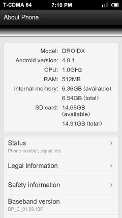

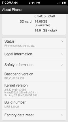

about phone:
android version: 4.0.1
bp_c_01.09.13p
kernal version:
2.6.32.9-g34b306dbmvq37@zin22lnxdroid28 # sat aug 20 10:40:49 ist 2011
build number miui-1.10.21

If you try to boot into recovery there is only one way to do this on those types of roms when your phone first turns on at the logo you will see a blue light for seconds. Quickly hold the volume up/down to boot into the boot loader and go to lastest recovery.
Are you wanting to know how to SBF the Droid X?
thank for your reply
all i wanted to do is that. revert back to it's original stock OS
i don't have recovery data. i have already delete the sd card few time already.
if i can get step by step help how to get this phone into it's original
verizon stock OS that would be great.
i need to know what i need. what needs to install in order to do this.
downoad link will helpful
waiting for reply
again i really appreciate any help, i can get.
i am new to all this
thanks
Go to YouTube and look for droidmodderx sbf guide the links are all in there for rsd lite and the sbf file. That way you can watch him/ her whomever sbf a phone it's easy.
I use windows 7 on my PC and only have used that method of sbf the Droid X if you need help further just look in these forums or of course post here.
