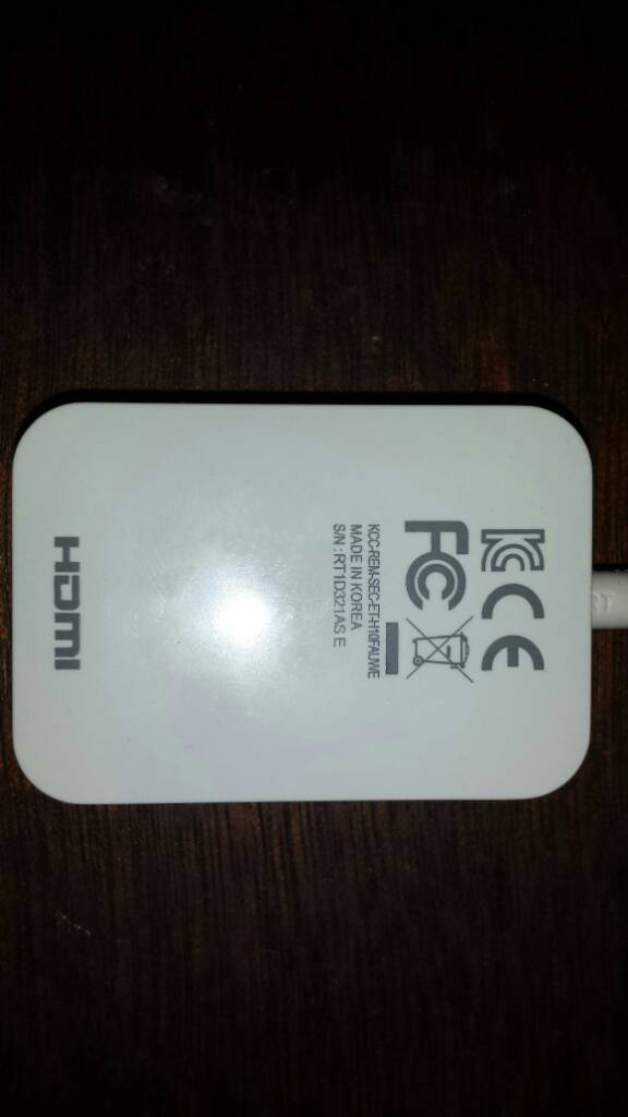

I noticed that you listed the part as (ET-H10FAUW, White)
The one I got is (ET-H10FAUWE, White)
Is that what you have?
Now that i am looking at it, it does have an e on the end. Wtf. It looks just like the picture. I did a search on samsung site and nothing came up with the e on the end. Thank you for pointing that out. Noe the question is what damn adapter do I have?
Damn, after some research, I have found that I got the UK version of this adapter that was designed for the octa-core phone I9500. I live in the states and we have the quad-core. I just can't believe there are two different versions. I'm an idiot.
You can only see this product on the UK site. I did not realize when I was searching on the US site it was bringing up the closest match. Damn.
