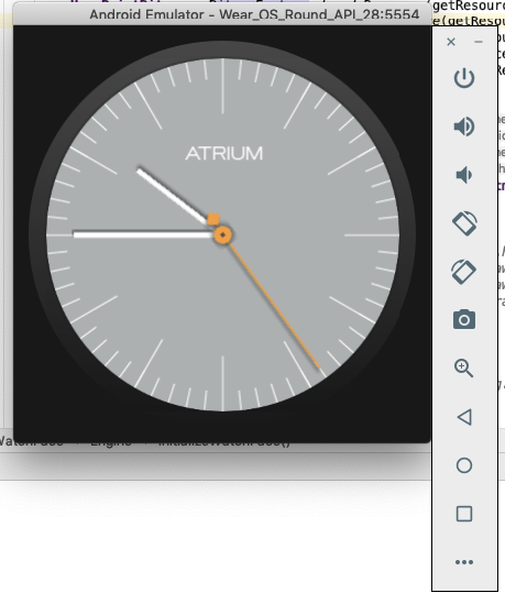

I think i find out the answer. We were looking at android emulator where elements looks horrible, but on actual watches it needs to look nice and smooth

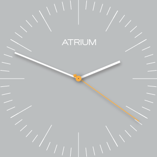

Hi! I just hired a freelancer to make a watchface. I saved my main artwork along with all elements ( watchhands ) and send to him. An he shows me the result i that makes me scratch my nape. In attachement first image is what i saved from illustrator and other one is what he got.
What is goin on here ? I think it may be caused by emulator resoulution or what ?

Well, he's sent you a screen shot, so it's going to look bad to begin with. I'd have him send you a vector file of what HE created....
