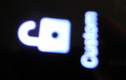

Does anyone know what this means when I boot the phone? Sorry it's a little blurry - I took it with a camera. It says "Custom."

Thanks Mike. That's what I figured, and might be responsible for getting messages after the update about things not being completed properly.
Do you think that means I need to still flash the VRLAC bootchain as directed by the guide as a first step?
Also, the last step is to flash the original JB bootchain. I wonder if the bootchain after the MF1 update with the new features would be different from the "original" one in that link? Has there been any reports of people having a problem using the guide and it's software on phones with the latest updates?
