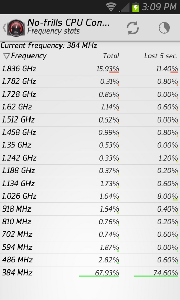

I have been playing with the CPU governor settings and it seems like the changes never take. I have tried to set the governor max at 1.458 and a min of 486 but nothing works. I still get 1.836 and 384 usage. I am using No Frills but I also have ROM Tool Box Pro. Could one be affecting the other?
*Edit-I have the box checked for "Prevent Changes From Other App" in the settings for No Frills.

Hmmm... 1.67 GHz isnt showing...that's supposed to be there. It shows to be spending most of yhr time on 384 MHz. Is it lagging?
No, I have been trying Badass governor settings and noob scheduler. The only game I really play is Candy Crush and that plays just fine. Phone works great, but it seems like I can't adjust CPU settings.
Using these settings and the CPU running at 1.836 I get a score of 12515 (using AnTuTu) which is about 1000 points higher than anything I have ever had with this phone.
OK, I think I may have figured out why I couldn't edit the Max and Min. I had No Frills linked using Link2SD. I removed the link and then tried to change the settings and that worked. To test it I ran another benchmark test and got an 11537 and the CPU Maxed at 1.458.
