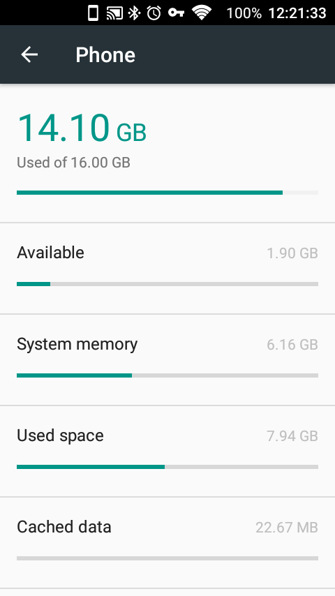

Settings
Storage
Phone
Available is what is empty.
System Memory is what the system uses (non-negotiable).
Used Space is what you have used- apps, data, files, pictures, etc. This can be altered by you, by adding, deleting, or moving this info onto an SD card.
Cache is the cache junk for all apps combined. Only OS of 7 and earlier will show this. You can clear this, and no important data will be lost.
