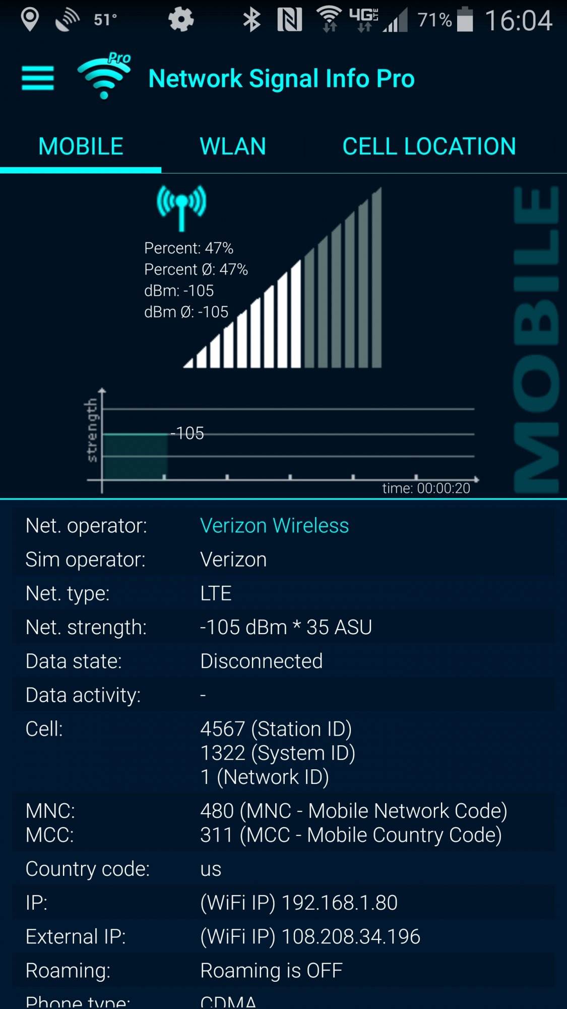

I just brought up Network Signal Info Pro, and started watching it.
I'm seeing values in the -107 to -109 range ATM.
As my avatar indicates, the cell tower is "way out yonder" about 26 miles east of me.
I ought to walk around the house and yard, but it's too cold for that now.
I have seen it as low as -115 at times, don't recall the time span.... When I first moved here 4 years ago, there was NO Verizon signals available within 5 miles of my home... they seem to be updating things as I now get LTE most of the time.
There are times though, when 'X' is all I get.

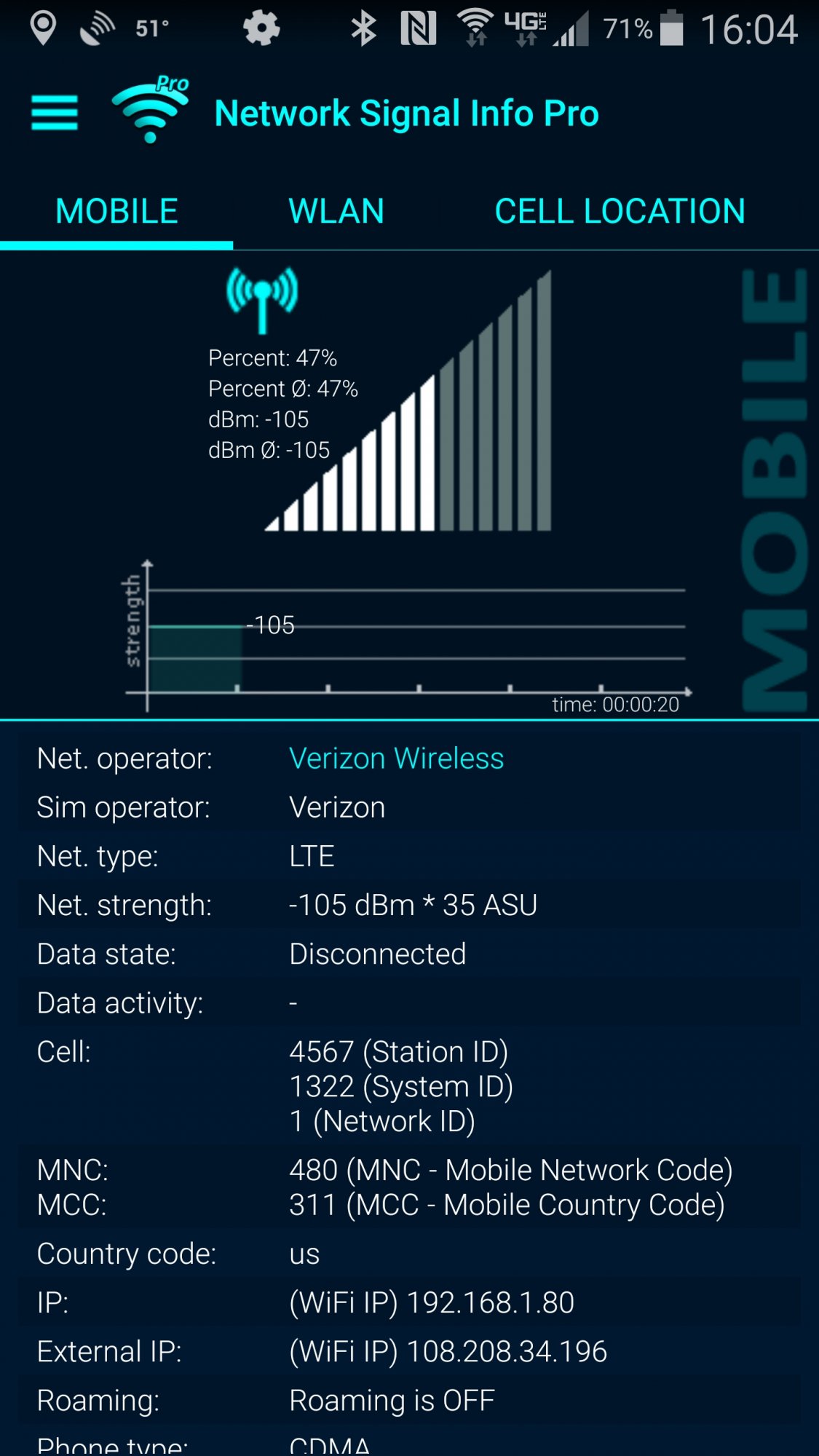

. View attachment 97626
Yes it appears to me also that Verizon is increasing their signal strength in my area.. I just can't explain why with my phone the signal fluctuates so radically and at such a large difference. 1 to 5dmb difference is pretty normal but 20dbm difference is pretty huge. It never did this before the signal strength increase recently.
I also use Network Signal Info Pro.. Great little tool.. I just wish it would pick up the towers in my area.. When I go to the cell map there is never any there. It should auto detect the towers and add them to a data base on the fly.. Piss poor design.
