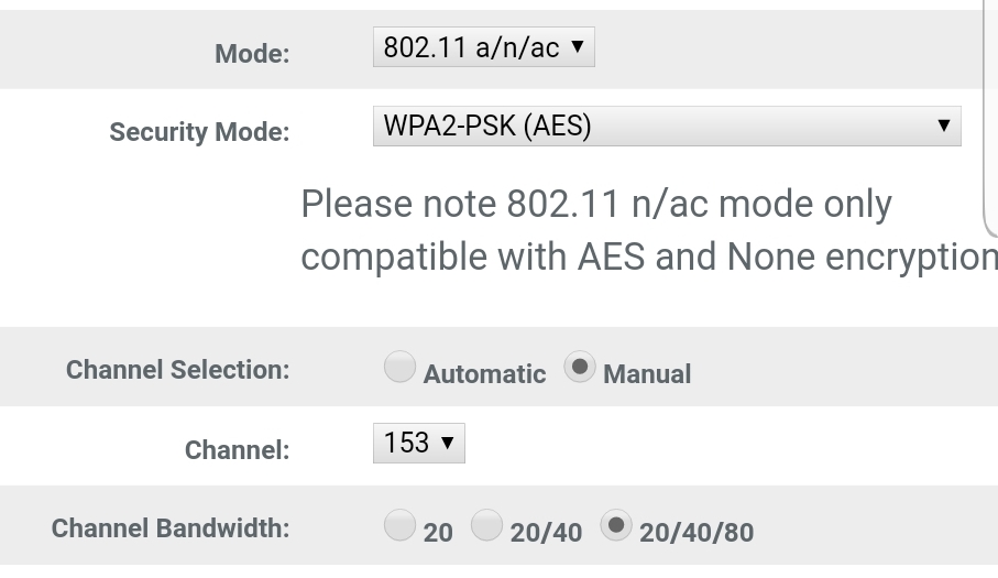

I had the same problem with my Note 9. Went into my router settings and changed my wifi channel to manual and set it to channel 153. Been problem free for weeks.
