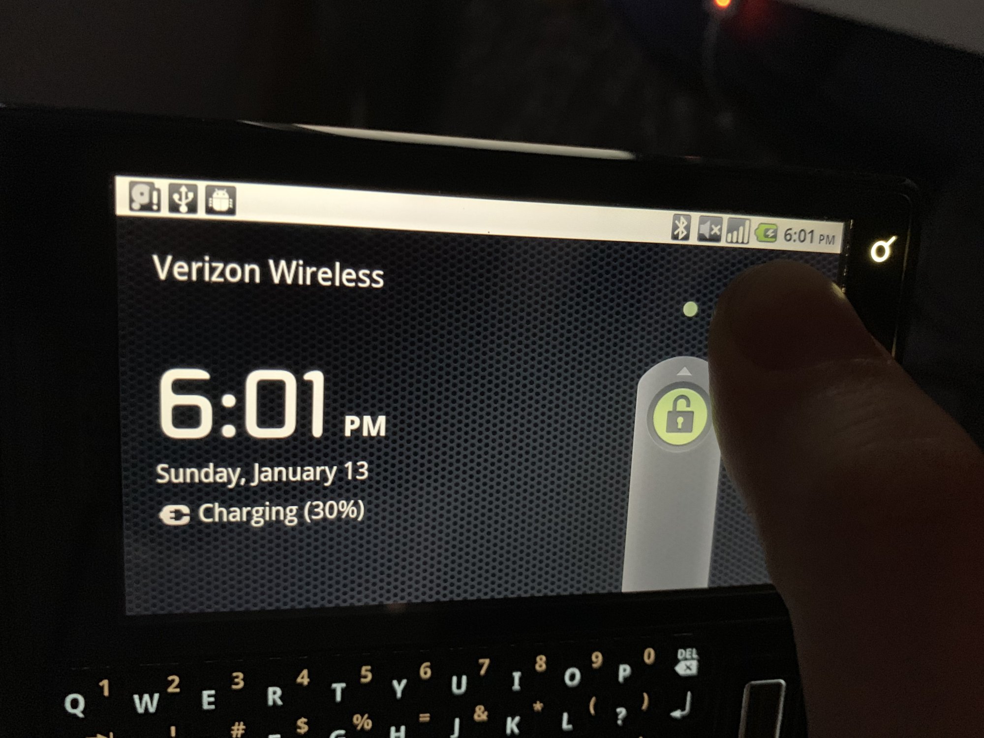

I have an old Motorola Droid 1 (A855) that I wanted to turn on and check the contents of. The problem is a majority of the display doesn't work and I cannot unlock it. Is there a way to plug the phone into a computer and manually import data on it or some kind of emulator that I can use to manually manipulate the display?
I don't know if there was any kind of encryption that is on the phone that prevents data from being retrieved unless it's unlocked. Picture attached of how far the unlock slider will go. Any help is appreciated.
