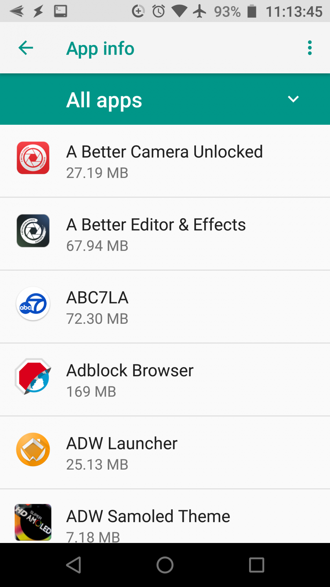

Not true. :) There's nothing [good] those apps do that you can't do yourself with Android's built-in tools. For example, clearing 1+ GB of unneeded files--you can delete those yourself by doing things like periodically deleting cache for apps such as browsers.
Look at your list of apps; you should see how much space each is using:

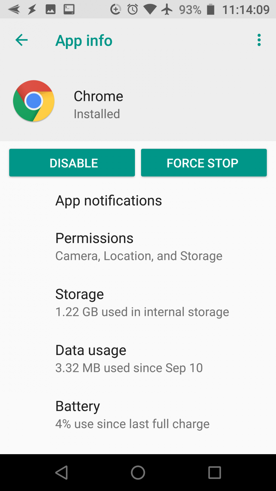

Now choose one that's using a lot of space:
Clear its cache; note the difference:
Don't buy into those apps' claims of being a necessary addition to your Android device. They're not! I've never touched one--and I've never had space problems.
