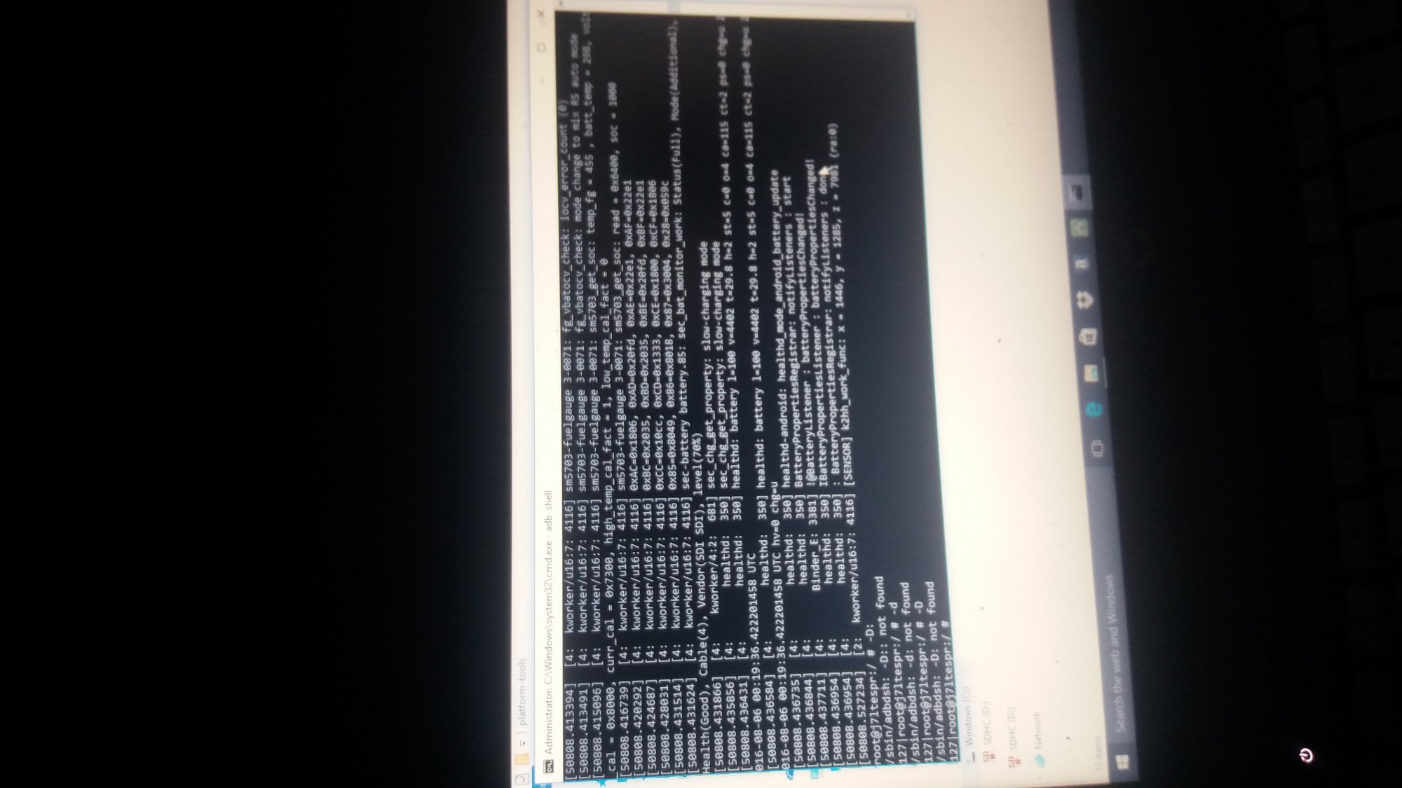

Modified adbd uses /sbin/adbd : as its terminal shell
Original adbd uses /system/bin/sh as its terminal shell
