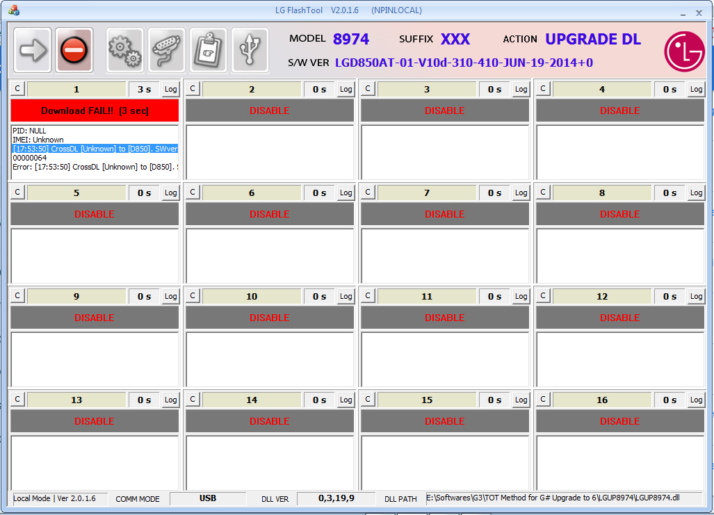

When I connect phone with laptop it shows in device manager but nothing shows on phone's screen. I pulled out battery and then inserted again, connected usb cable while pressed volume up key then tried to flash using LG Flashtool 2014 with stock files but it ends up with an error.
"Download FAIL!! (3 sec)"
PID: NULL
IMEI: Unknown
[17:52:50] CrossDL [Unknown] to [D850]. SWver
00000064
Error: [17:52:50] CrossDL [Unknown] to [D850]. SWver
Please help if anyone has its solution, it will be highly appreciated. Thanks
