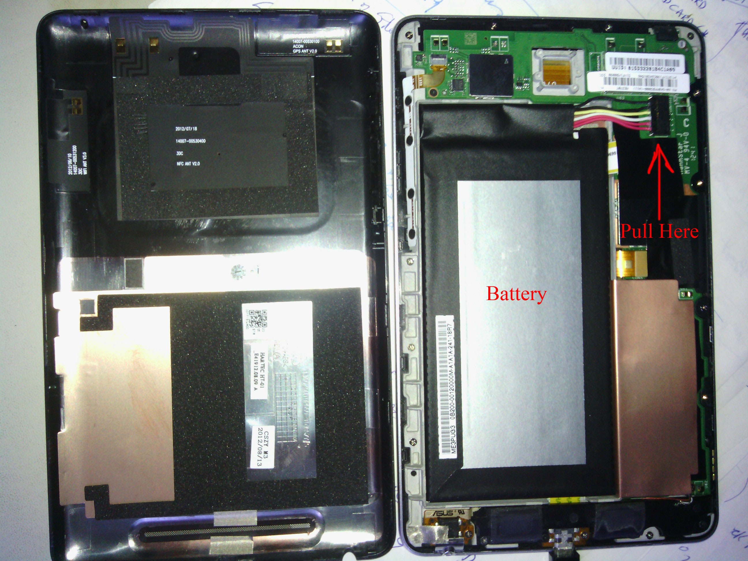

Just in case you or anyone else get's stuck again, and there's nothing the buttons can do to re-boot, or turn off, and your hair is turning white and falling out in clump's, it's OK to pull the back off the Nexus 7, and unplug the battery.
I've done this, (several times now), after remembering I'd read a post (somewhere, sorry no link to give right now).
Just use a very thin type of flat tip micro-screwdriver, start at the place the tablet halves are "open" which is at the tablet's USB connection, and "very carefully" pry at that place till the plastic case half's pop's it will be at several place's you need to gain access in this way slowly "pop" the connection all the way around the tablet till it "pop's free. Than work free the wire harness from it's connection and it will turn off the tablet.
Of course, don't have the USB cable attached, or you will be powering the boot-loop with your PC.
Here's a screen shot and little red pointers to where you must pull apart the wire harness to undo the battery.
Good luck.
