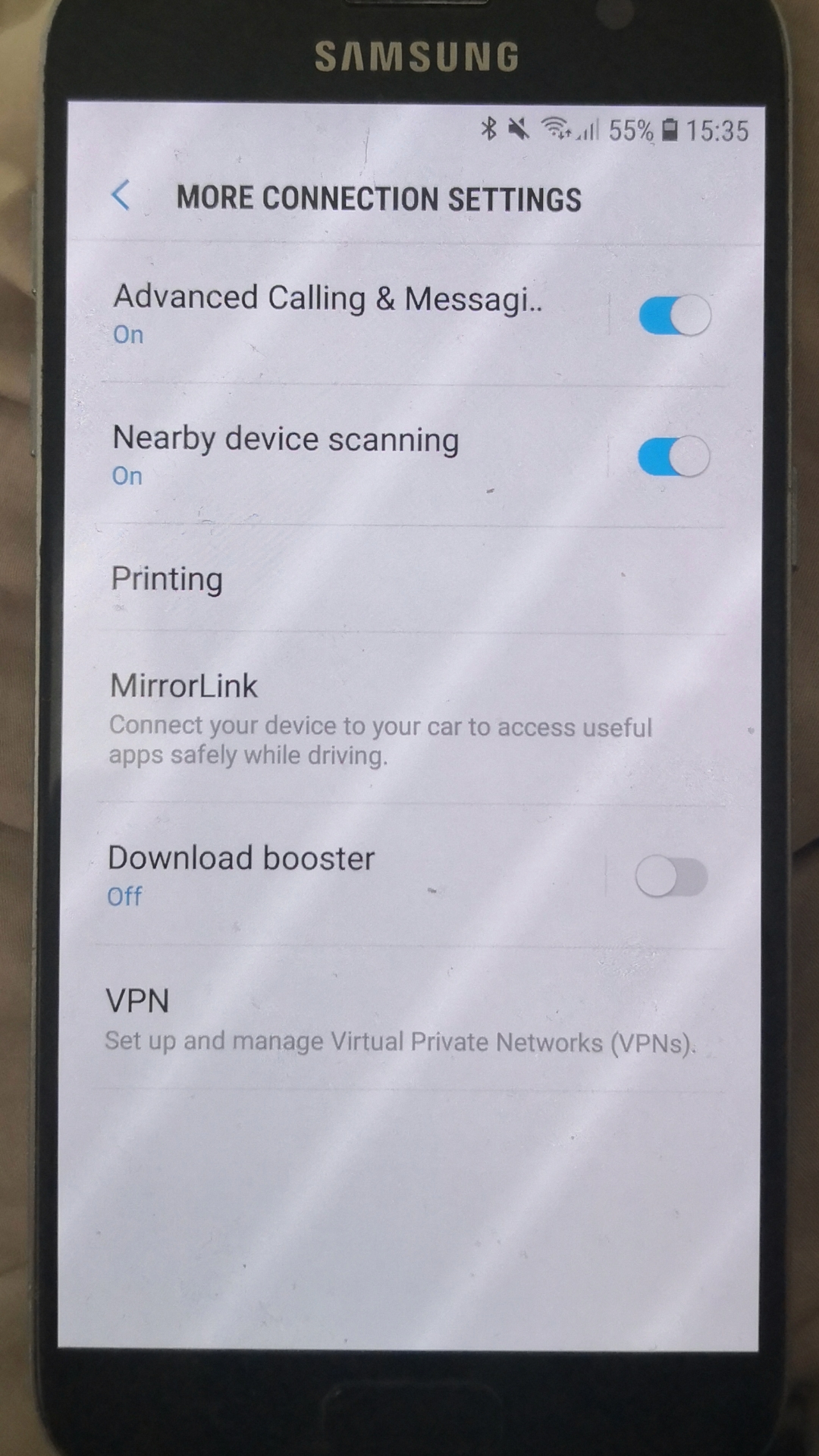

On my Verizon phone, this is How to turn off Amber Alerts on the Galaxy S7 Edge: 1. Swipe up or down to display the gear icon to access SETTINGS 2.Navigate SETTINGS > CONNECTIONS> MORE CONNECTIONS SETTINGS (way at the bottom) 3.Tap EMERGENCY ALERTS 4.Tap the 3 dots in the upper right, then tap Settings 5.Tap ALERT TYPES 6. Select any of the alert types and turn off.
Thanks, SeaofBlue, but I don't have an option called Emergency Alerts under MORE CONNECTION SETTINGS so you suggestion doesn't work for my phone.
Yeh, my S7(bought in the UK) doesn't have that. So it must be something that's only in carrier version S7s in the US?
