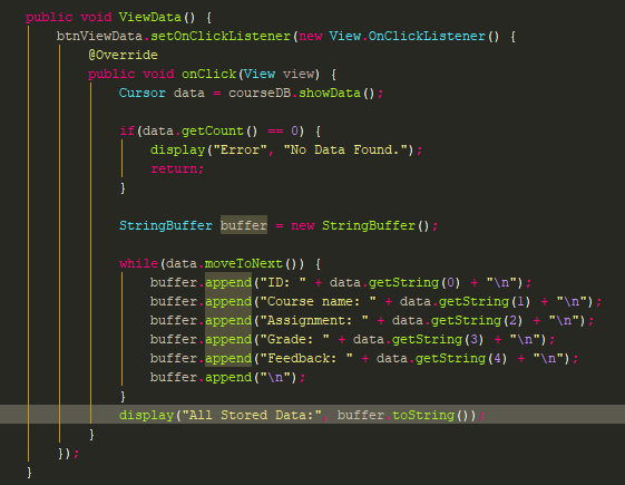

This code
Code:
while(data.moveToNext()) {
  buffer.append("ID: " + data.getString(0) + "\n");
  buffer.append("Course name: " + data.getString(1) + "\n");
  buffer.append("Assignment: " + data.getString(2) + "\n");
  buffer.append("Grade: " + data.getString(3) + "\n");
  buffer.append("Feedback: " + data.getString(4) + "\n");
  buffer.append("\n");
  display("All Stored Data:", buffer.toString());
You're calling display() on each iteration of this loop, which displays a new alert dialog each time you append record details. I suspect it would work better if you built your entire String, then called display() after the loop completes:

Hey LV426, your logic on this problem makes perfect sense. But it's causing my app to crash when I click the 'view data' button. For example, if I implement your code example as:
The app crashes when the the 'view data' button is clicked. Am I missing something obvious here?

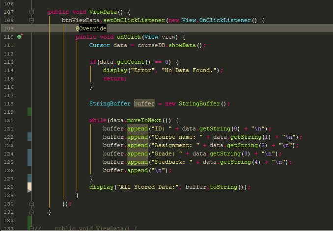

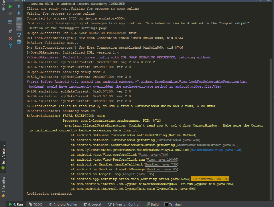

Is pasting the logcat code enough? - I can make a video too if that would be more helpful. Here's the logcat output when it crashes:
And that crash happens with this 'view data' button code:

The error message is pretty clear. You're trying to get column 4 (Feedback) from the result set, which doesn't exist.
Btw the code you present here is now out of sync with the stuff on Github, making it even more difficult to answer your questions.
Ah of course, of course, of course, sorry I was looking at this issue after very little sleep and see what a foolish error I made there. I have now implemented your instructions, everything work great, I have published the corrected, functioning code to my GitHub repo, and once again I am absolutely indebted to you for your generous assistance. Many thanks LV426, you are truly a hero among heroes and I have learned much from your kind assistance. Cheers pal.
