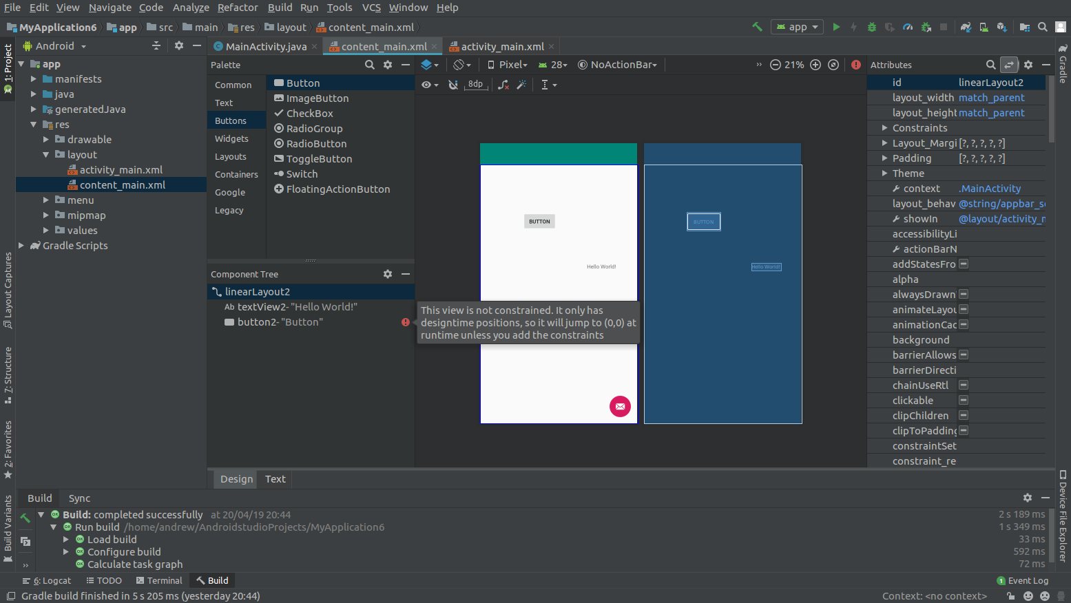

I've been doing some experimentation with ConstraintLayout. It's not something I've used before, but I can see the benefits. The main one being that you can drag components around in the UI editor, and pretty much place them where you want. That's very cool.
What I did was start with the basic UI layout, and add a Button. You can see from the first screenshot here that the editor is telling me that the Button will be shown at co-ordinates (0,0) when the app is run, because I've defined no constraints. That pretty much explains what you're seeing in your first post.

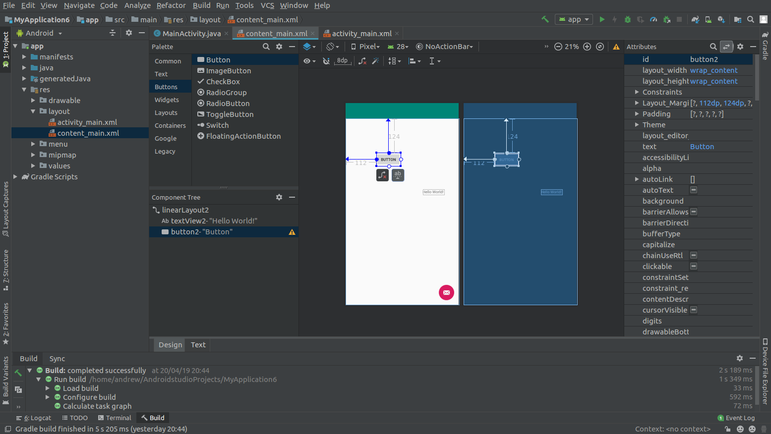

So I then added some 'constraints'. These are rules which determine where the component is placed, in relation to something else. If you right click on the Button in the editor, you get a sub menu called "constrain". Using these options you can set horizontal and vertical constraints. Once these constraints are added, you can then continue to drag the Button around to different places on the screen. I suppose you can add constraints in relation to other components on the screen, so they will reactively resize for different screen configurations.
You can also use the 'infer constraints' button, as @wseng92 mentioned in the above post. This will add default constraints to your components. That should have resolved your problem. If not then there are some other issues. Can you attach a screenshot of your layout editor?

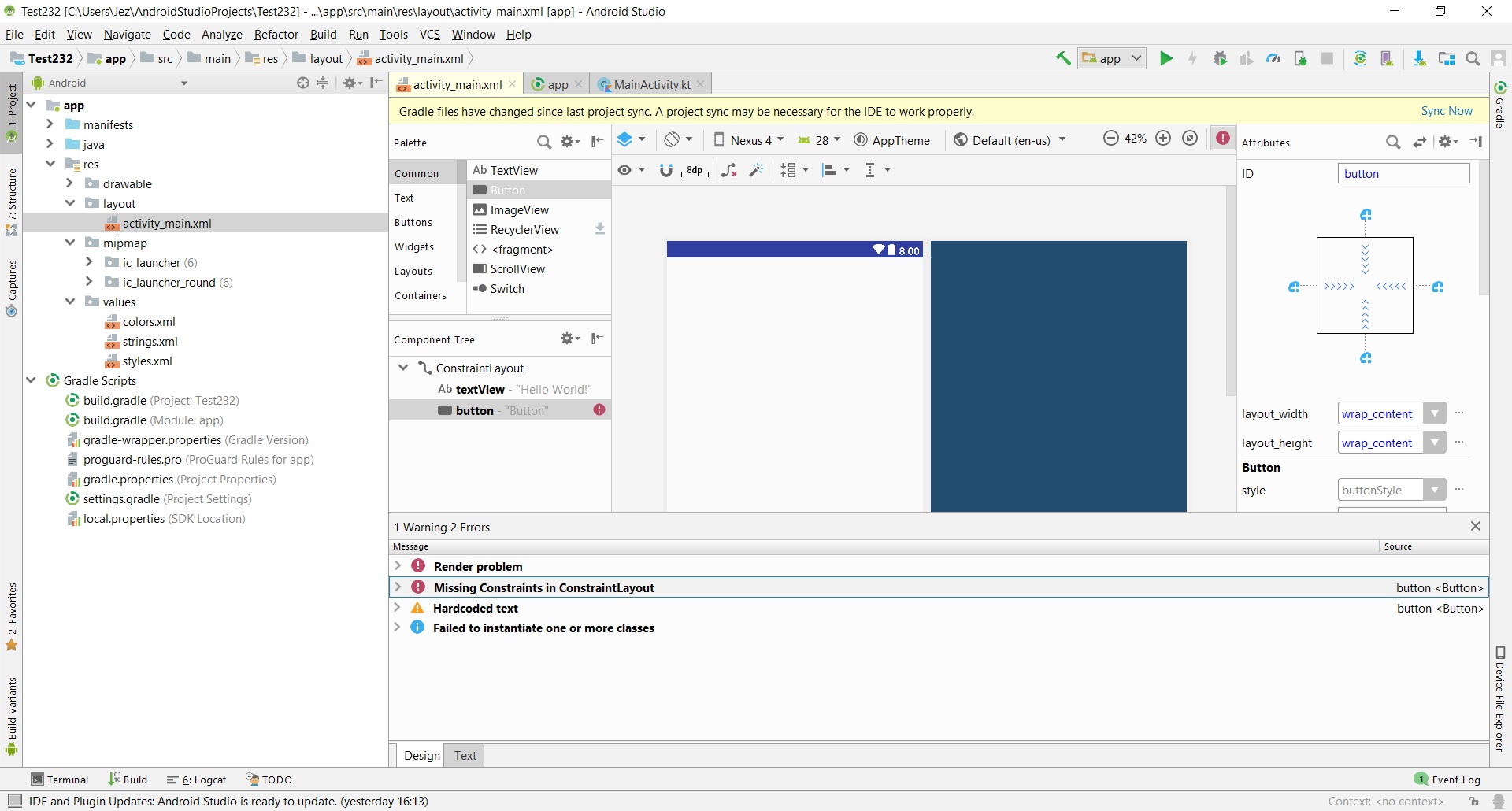

(From the other previous post) When I go to app/res/layout there is only one XML file rather than two files: activity_main.xml is there, but I can’t see content_main.xml?
Looking at your later post, when I try and put a Button on, I get (I just noticed) 1 warning & 2 Errors.See the picture.
Is the first problem (missing XML) the important problem please?
Many thanks for your time and help!

You see that red exclamation mark next to the Button? That's because it has no constraints.
You can either click the 'Infer constraints' magic wand in the toolbar, or add the constraints as I described above.
I think that had worked – THANKS!
