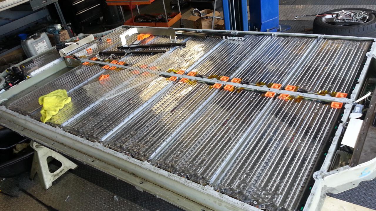

When you're trying to charge 6000+ 18650 LiIon cells simultaneously in a series and parallel arrangement, might be that some overcharging and balancing of individual cells is a problem?
When I charge 18650s for my vape, I always charge them 100%, same with my phones.
Tesla battery pack has a computer to monitor and control the charging process. I guess that the 90% recommendation is for battery health and better lifespan and it's not danger to charge any battery to 100%.
