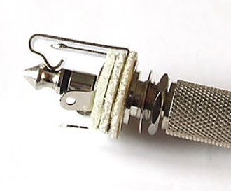

From what you've described the metal contacts in the headphone jack itself might be 'stuck' in the wrong position. If you need a visual on what's going on:
When you're plugging your earbuds in, there's a spring loaded metal contact that gets moved changing the path of the audio signal from the phone's internal speaker to the earbud's jack. And when you remove your earbud jack the metal contact goes back to its original position. The headphone jack is essentially just an electrical switch, so a software solution to this would require quite a bit of manipulation to bypass the situation. You could try manually cleaning the inside of the headphone jack port itself -- really good, focused lighting and a steady hand required. You could also try picking up a can of electronic contact cleaner and give a small squirt into the port opening (it doesn't require much, less or more).
