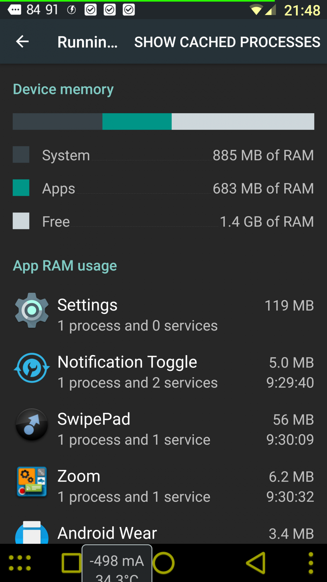

While you're there in developer options, open "running services". It gives an idea how much memory is tied up by system and high priority apps that have running services. The apps on this screen are occupying a high priority portion of memory and cannot easily be removed by the system (in contrast cached apps are low priority and system can easily grab that memory).
If you have low free memory in this screen, then go through those running services and see if any are associated with apps that you can disable or uninstall.
Also, a longshot, how much free space do you have on your internal sd card.

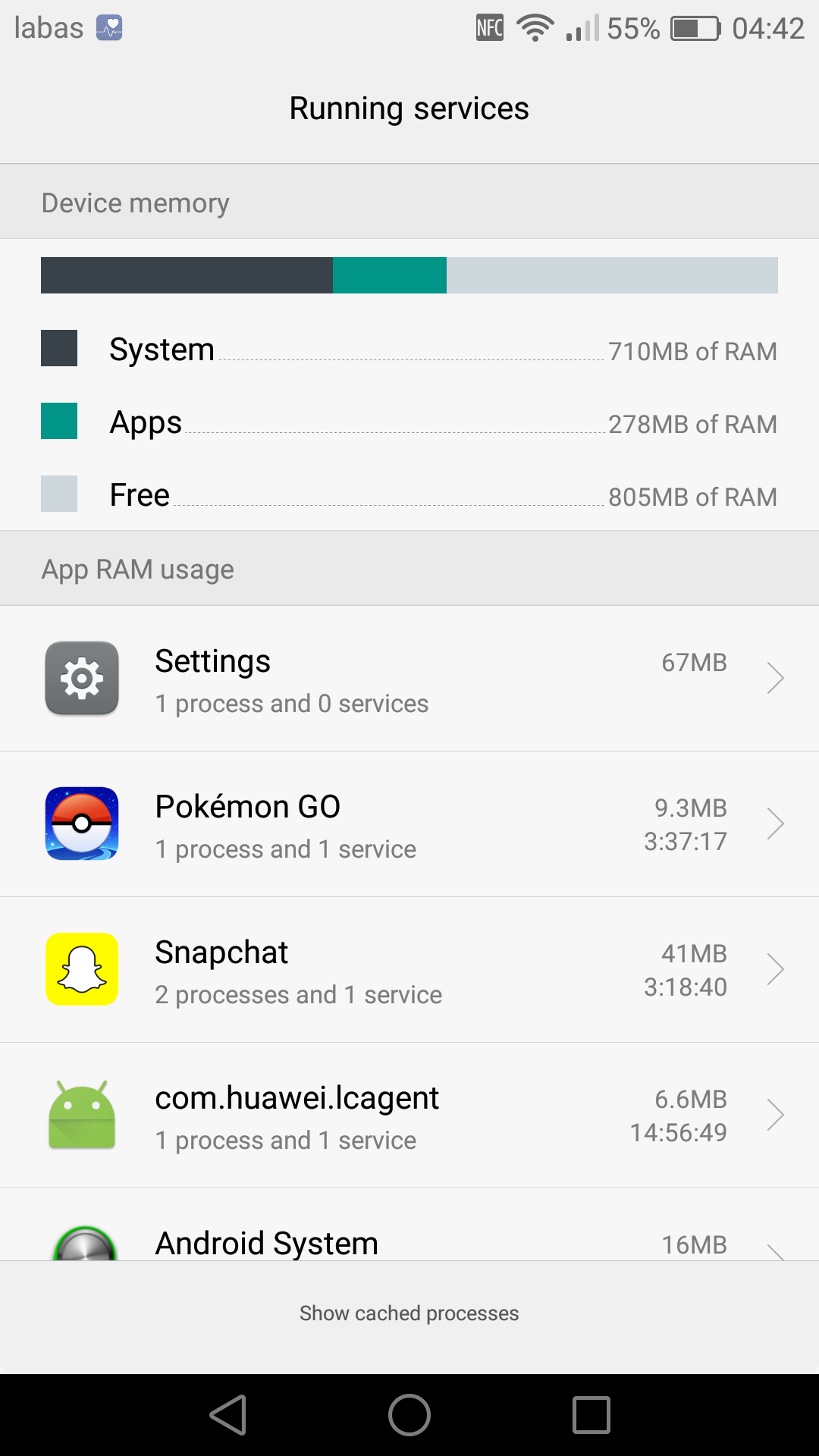

2 max, on standby ~800 free(6.0 eats a lot)
