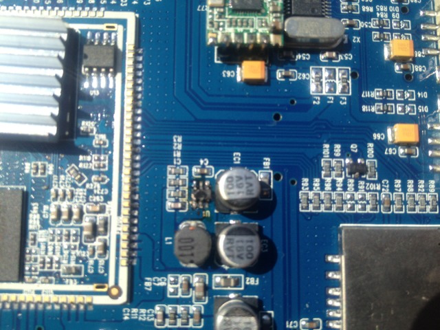

O opened my box and I found this:
It's toasted..
Anyone knows what's is this for?
Any fix?
