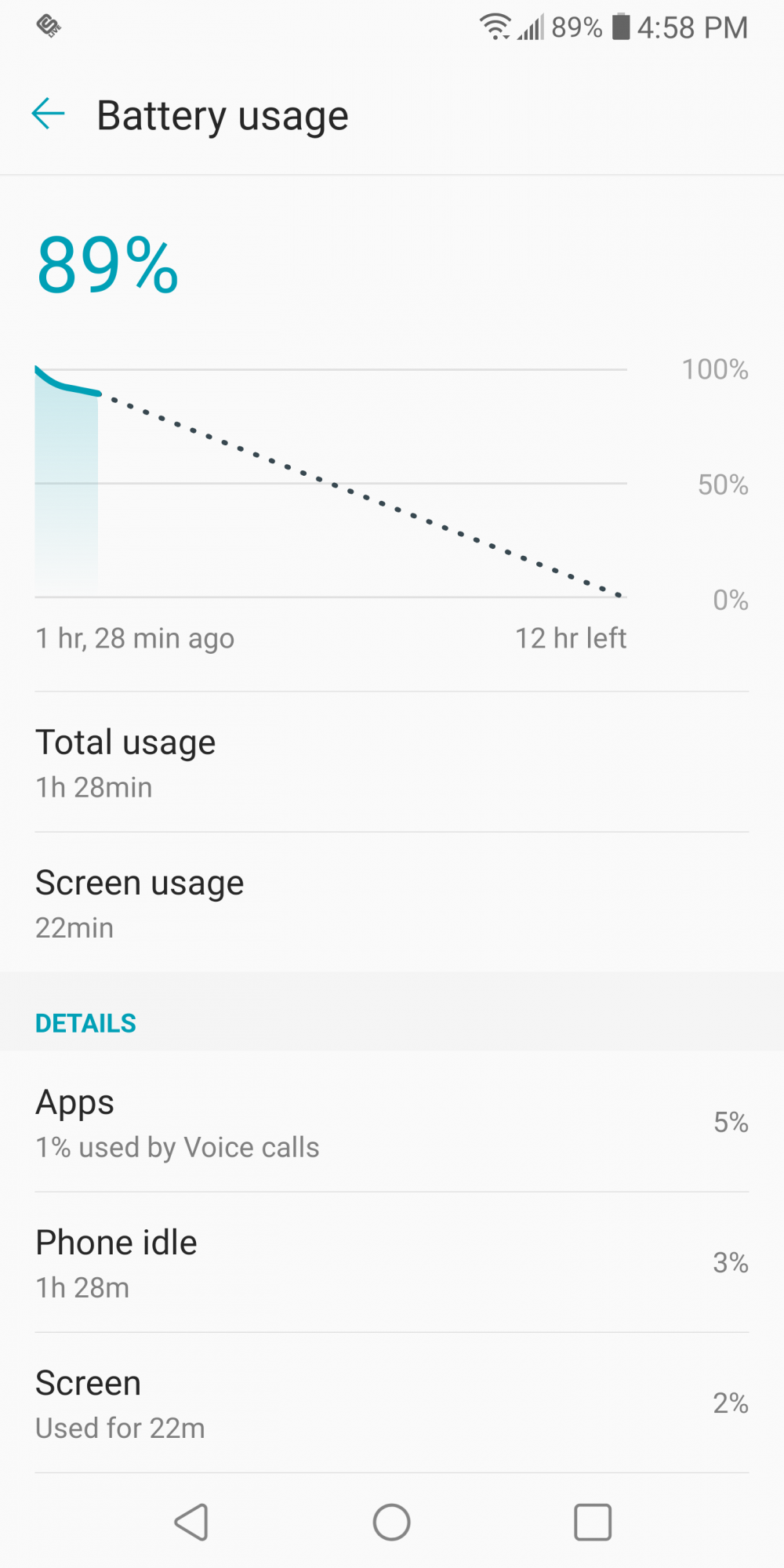

Okay. I will fully charge it tonight and then post a screen shot of what it says in the morning.
Okay so last night, I installed and ran AVG. I then deleted the app and reset my phone. I charged to 100% before bed and woke up about 6 hours later and the battery had only drained a normal 7%. I'll keep monitoring the phone but so far so good. My other problem with delayed notifications is still happening though. It's been that way since my 2nd Oreo update. What I mean is that if my phone is in standby mode/sleep, I don't get notifications right away. Pretty much anytime I go to check my phone, liek 4 emails pop up/words with friends and other notifications go through. Sometimes as long as 12 min my emails won't show up when in standby. I have already gone into the settings and put them as priority and it doesn't help. I was hoping the new OS Android 9 would fix this issue but it hasn't. I have learned to deal with it. Overall, I am not really liking the LGV30 and it was the most expensive phone I've ever bought.

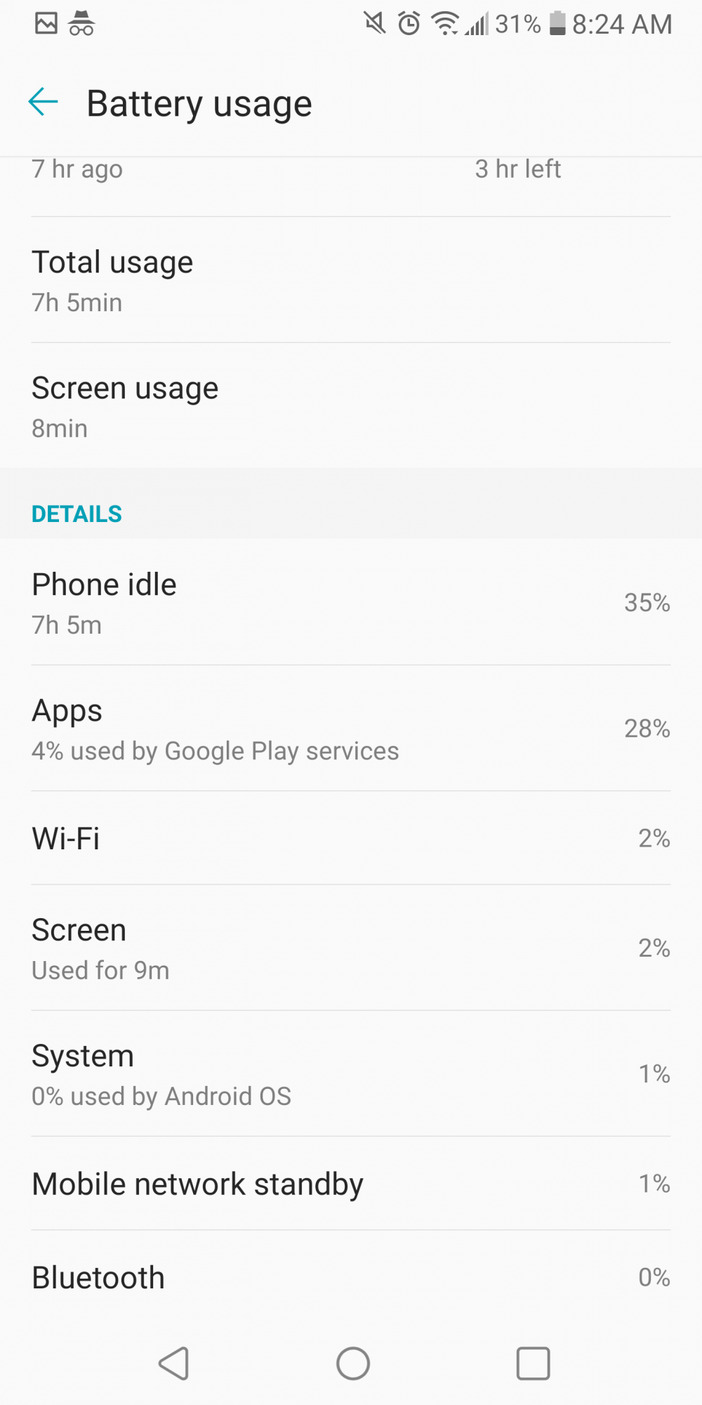

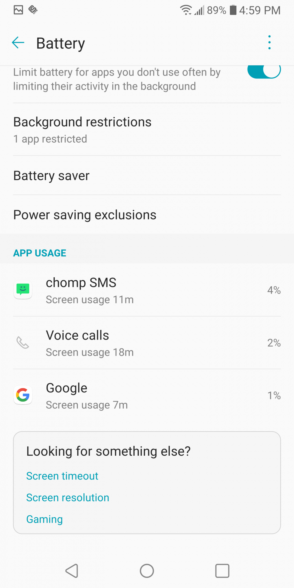

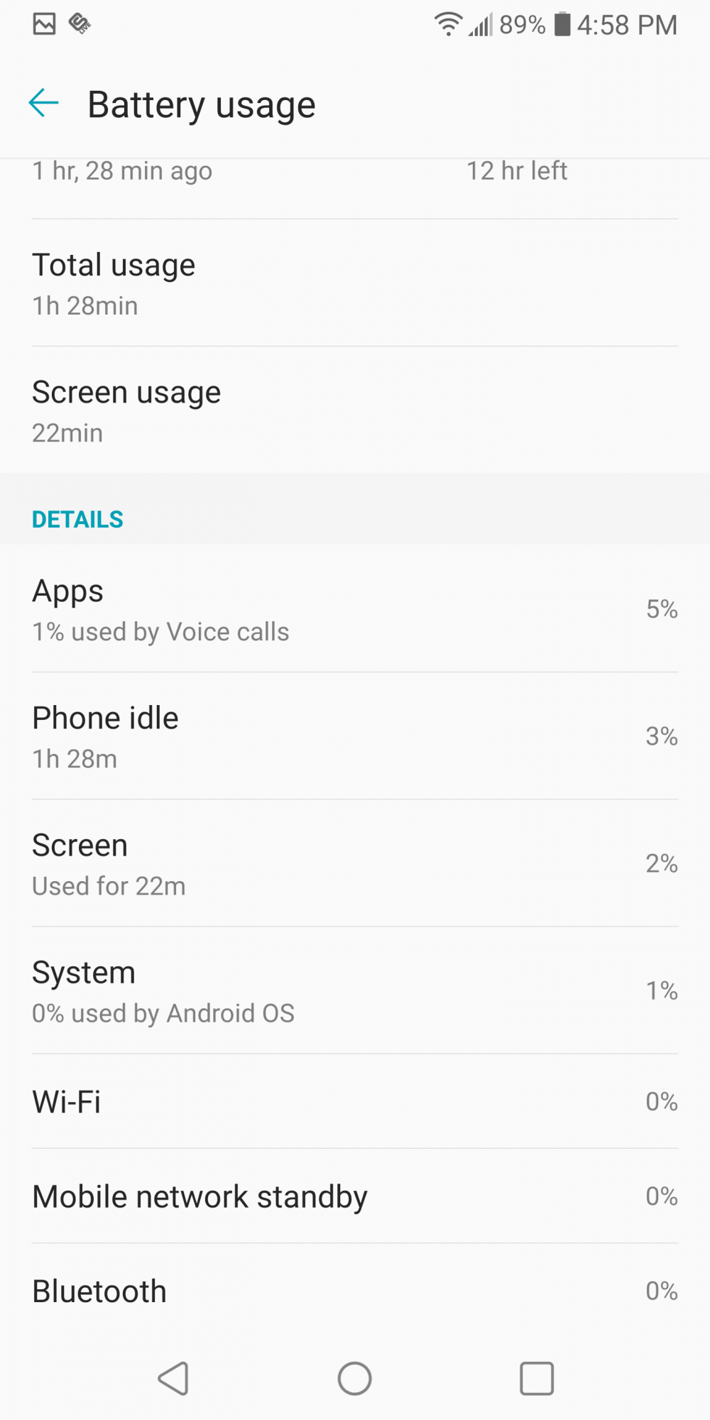

Battery drained again big time last night. Here are the pics.
Hmm, so the system battery info is only accounting for 1/3 of what it says was app usage. But "phone idle" at 35% is weird, especially since your mobile signal looks OK (if it was marginal then you can get a lot of drain from that).
All I can think of is try a third party battery monitor (GSam for example) and see if it can give you better info, or else try backing up and resetting and see whether that improves anything.
Not being able to exclude the email app from battery optimisation is poor, but that must be an LG thing. However that's not the cause of the battery drain, as excluding it could only increase battery usage.
