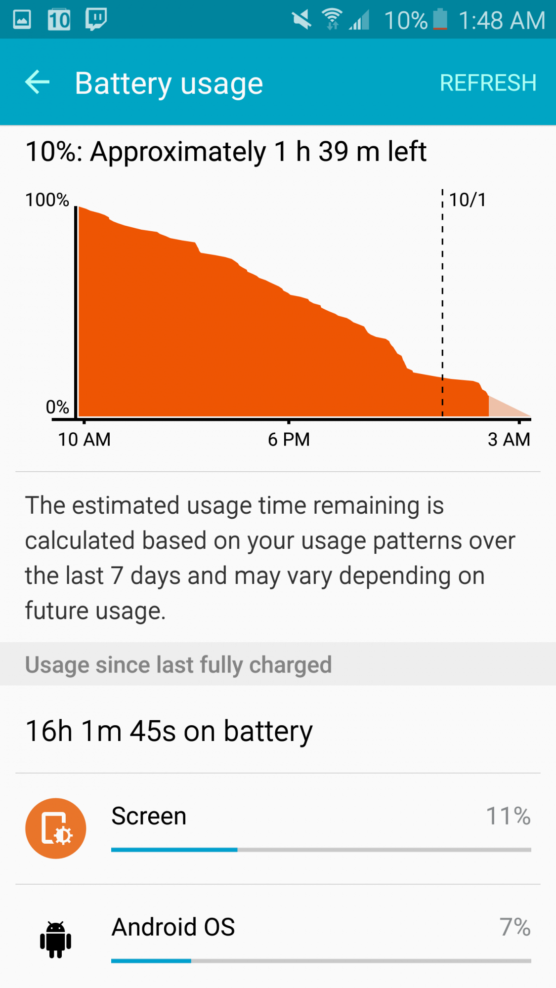

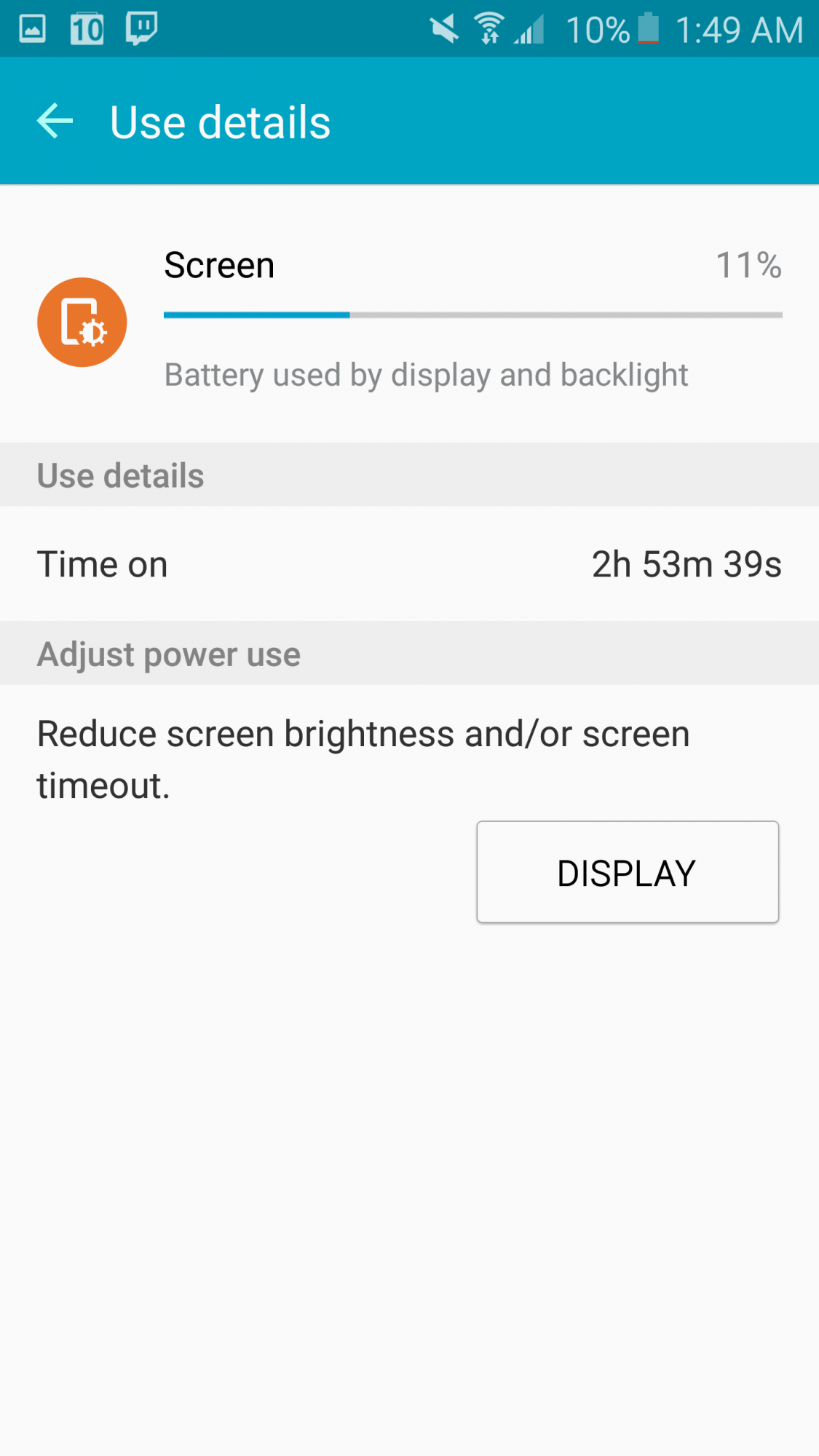

Hi my battery life on my s6 has been draining fast I'm not even getting 3 hours of SoT time not really sure why. I've done what the battery sticky thread has said to do but still no improvement. Screen is on 25% most of the time.
