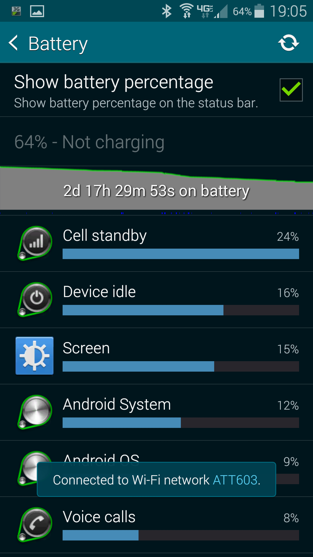

The screenshot shows my phone at 64% after being off charge now for 2 days and 18 hours. that's almost 3 full days.. The only use my phone has had is two conversations of about an hour, and several times looking at the Settings Menus to help forum users, looking at how to write up macros for a specific user's needs. In other words, short screen times... I just checked it, Screen time is 1 hr 30 minutes.

Okay, you are asking me "What the Hell does this have to do with 'My S5' "... I am trying to show you that you must have some apps running in the background, or you have a lot of screen time, or you don't turn OFF your data and Wifi radios like I do.
I use MacroDroid to automate the way my phone is used. ie, if the phone is idle and laying on the table, the WiFi and Data radios are both turned off. Why? It is impossible for any apps to call home to ET and talk to momma and get an update. Updates? I have those turned OFF also, they aren't needed unless something breaks the app. then I will update that one app.
In other words, there is no CPU activity hardly at all with my S5 if it is not being used. It is idling at a very low power cycle and battery drain is extremely low.

Now that I am off work (I'm seasonal, 72 yrs old, drive a spray truck in the summers) I don't use my phone much, so it coasts thru day after day w/o using the battery much. see my screen shot. Oh, I got bored setting around at home, so I went back to work. Keeps my muscles moving, and my brain engaged.
