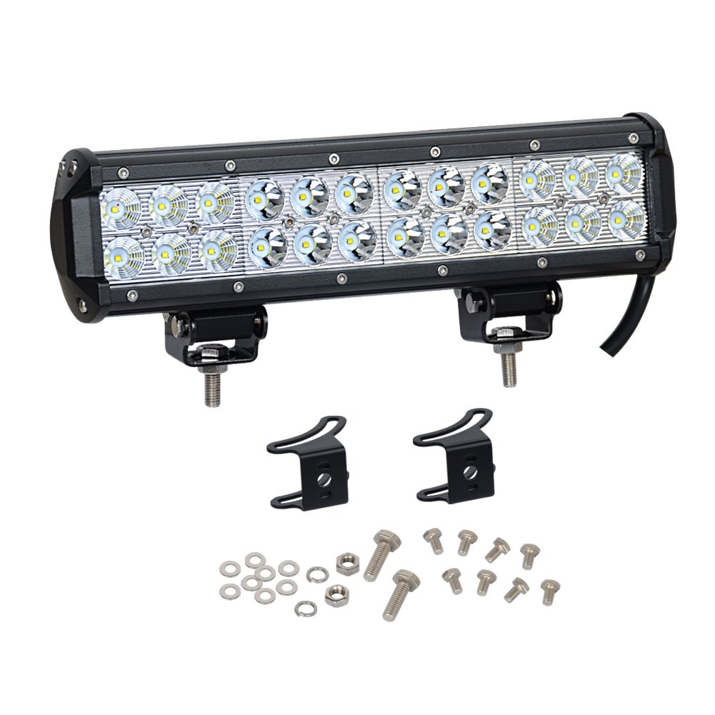

Now, I did some thinking and some brief researching and want to install an LED light on my push mower (21 inch, manual start) with a small battery to power it.
From start to finish, mowing my entire lawn, takes me about 2-1/2 hours, so I'd like the battery to provide the power needed for the time needed. After which I will recharge it until the next time.
That being said, I picked out the LED light to mount on the front of the mower:
72 watt
https://www.amazon.com/dp/B00WE46ZW...lid=3AH6AANV55RZQ&coliid=I1KTV69CYLRO9M&psc=1
and to power it, what battery do you recommend?
I need something small that I can mount on the mower and easily remove for recharge.
I was thinking about this one:
https://www.amazon.com/dp/B003S1RQ2...lid=3AH6AANV55RZQ&coliid=I37U2QKIRK89U2&psc=1
7 Ah/20 HR <<<------- what exactly does that mean? It will provide 1 amp of power for 7 hours or for 20 hours?
Being the light is 72 watts, how long would that battery be able to power it? Do I need a larger Amp Hour rated battery?
How many amps will that light draw per hour?
Based on this, the light will draw 6 amps. o.k....6 amps per hour????

It looks like it provides up to 7 amps for up to twenty hours. That would be 4 watt/hours.
The math is thus: 12v times 7a equals 84w divided by 20h equals 4.02wh

Let's replace my battery of choice's specs:
7AH @20 hours= .35 amp load for that 20 hours.

75 watts (lamp draw) , .35 amps (for 20 hours) = I need a 214.2857142857143 volt battery??????
Obviously that is not right and I'm an idiot :(
I'm baffled. The halogen headlights in my car only draw 55 watts each and they're good at night on the freeway.
I'm guessing you don't push the mower that quickly.
Why such a high wattage? Why not something lower? You could probably use a couple of L-ion batteries to power it and it won't cost much to recharge them.

I push it at a normal walking pace (I have a large yard) (yeah, I know, get a rider mower....I need my exercise :p)
Why such a high wattage? Honestly, not sure lol....I just don't want to get something underpowered and be dissatisfied with it. :D
What about punching my numbers into this calculator?
https://www.batterystuff.com/kb/tools/calculator-sizing-a-battery-to-a-load.html
I'd need a 48Ahr battery?
Am I being kinda silly wanting a 75 watt LED light? Be honest, I'm a LED light newb :D
No external battery required. You can remove them from the mower to charge during the day. Just have to figure out a way to mount to mower.
Or maybe an LED headlamp?

What about just a great quality L-ion powered flashlight with zoom? I have a couple of these, it throws a beam plenty wide for mowing. It comes with a charger and two of the larger L-ion batteries, and I'd bet one battery would last the time it takes you to mow the grass, especially if it turns out you can use it on the lower-power mode. Creative use of zip-ties should affix it to the mower handle.
https://www.amazon.com/UltraFire-XM-L-T6-Flashlight-Rechargeable/dp/B00MPCVLFE
I'd vote against a regular LED headlamp. They're designed really for closer-up work (great for working on your car for example) and are lower-power, so it's probably not practical. You could probably use a spelunking headlamp since some of those are designed for cave exploration and throw a tighter beam. Some of those have an external battery pack, too.
I found this one at Amazon, also with batteries and a charger, it really might be ideal. The lumen count is based on all three bulbs lit, so if you can use just the center you'll see better battery life. This might be really practical (since it aims where you look) so long as you don't mind the sweat under the strap. ;)

ooo, I like that flashlight idea!! It appears it has a clip on it to affix it to the bill of my ball cap!
Hmmmm, that may be something worth trying! Thanks!! :D
Edit: I may go with the shorter/lighter version, as the one you linked weighs about a pound.
