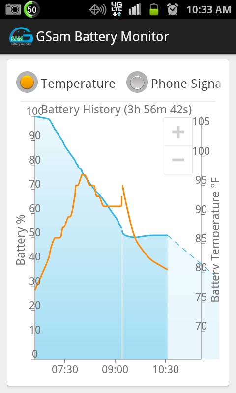

My Samsung Aviator is about two years old.
When I unplug my phone in the morning from the charger (every morning starting about three weeks ago), the battery temperature starts to increase and the battery drains at a very fast rate (generally, dead five hours after a full charge).
If I reboot the phone, sometimes the temperature will drop and the battery will start draining at a more normal rate.
I have bluetooth turned off, wi-fi only active when plugged in, and there are no active apps. I hardly use the phone.
It also seems to be sensitive to air temperature - when I go home in the afternoon (in a car that is, at first, hot), it starts the "fast drain" thing again.
Is this an issue that replacing the battery might fix? Any other suggestions?

Yeah, I've scoured everything under Settings->About Phone->Battery repeatedly over several days. It shows exactly the same stuff (display, cell standby, phone idle, android system, Google Services), in the same ratios, when it's draining normally as when it's sucking down battery. I downloaded a wakelock app to see if anything was waking it up - nope. The GSAM app I took the screenshot from also monitors when the display is on, and nothing is turning the display on (besides me, to check the battery status, because I'm paranoid about it now).

As I said before, I've monitored wake times and they are no different when the battery is draining normally vs. super-rapid battery drain. I've used both the app monitoring that comes with the phone and downloaded third party app monitoring software and no unexpected apps are running or wakelocking and app activity does not record any differently during normal drain vs. rapid drain periods. I factory reset the phone and left it in the factory reset condition for a couple of days - and saw the exact same behavior. It's difficult for me to believe, after investigating and finding this result, that it's anything to do with an app.
