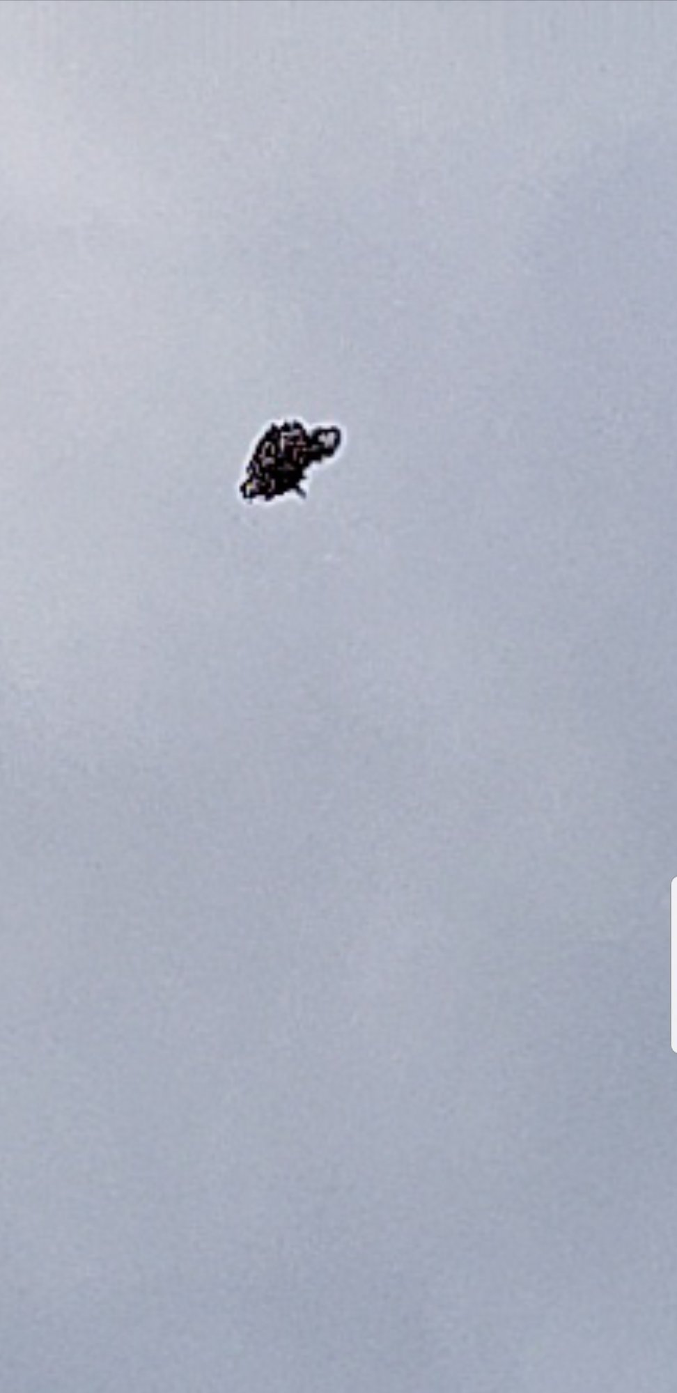

I posted a couple of the photos below, and screenshotted one zoomed in on the spot.
I just received that update, I'm not exactly sure when, but I'm thinking maybe it has something to do with it. I don't see anything at all in the lens
Anyone ever experience this?

Honestly I couldn't see a spot in any of the pictures except the second one but I assumed you drew that to show where the small dot was. Seems like a dodgy pixel in your screen to me since it doesn't show in the uploaded pictures.
See what you mean now. It was always hidden behind the left and right arrows. It's not a gone pixel so ignore my previous post.
