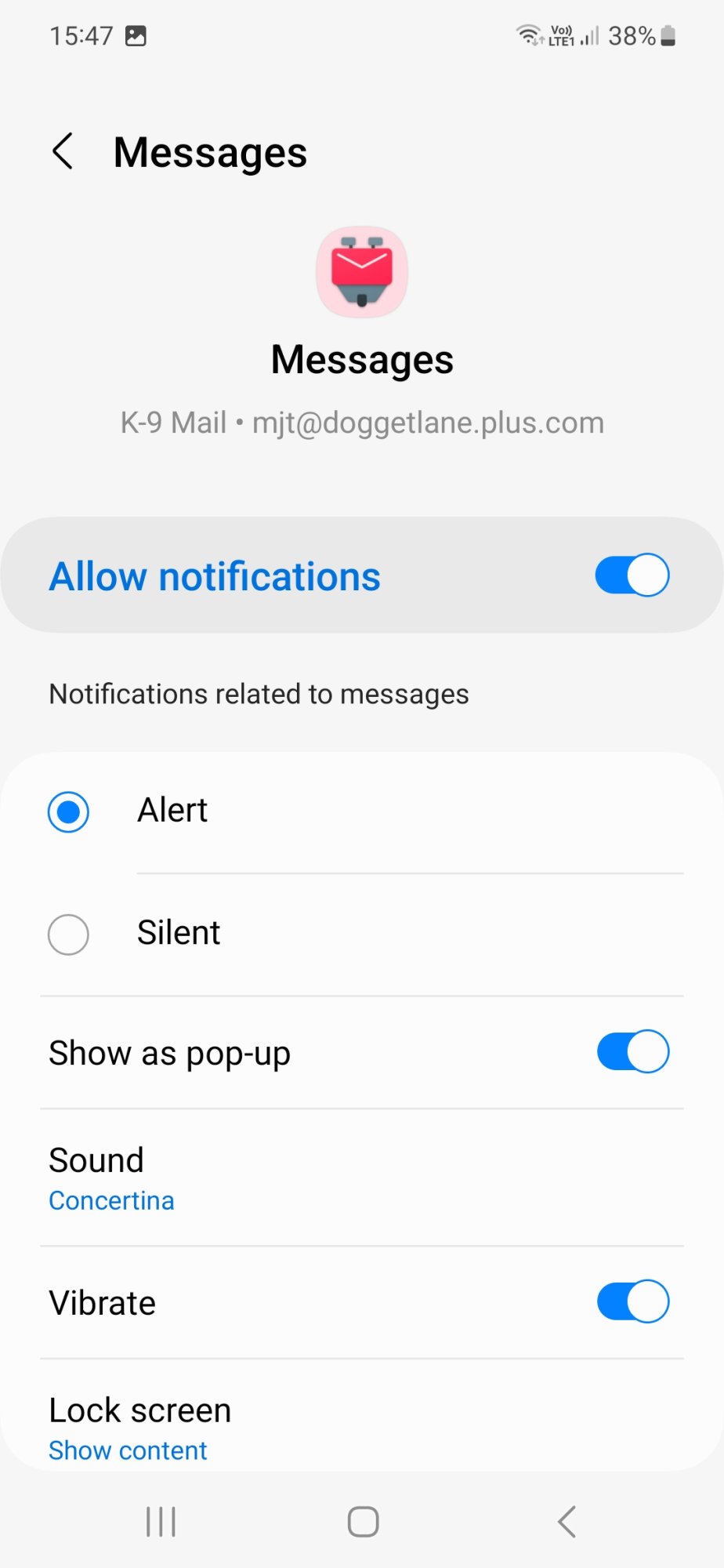

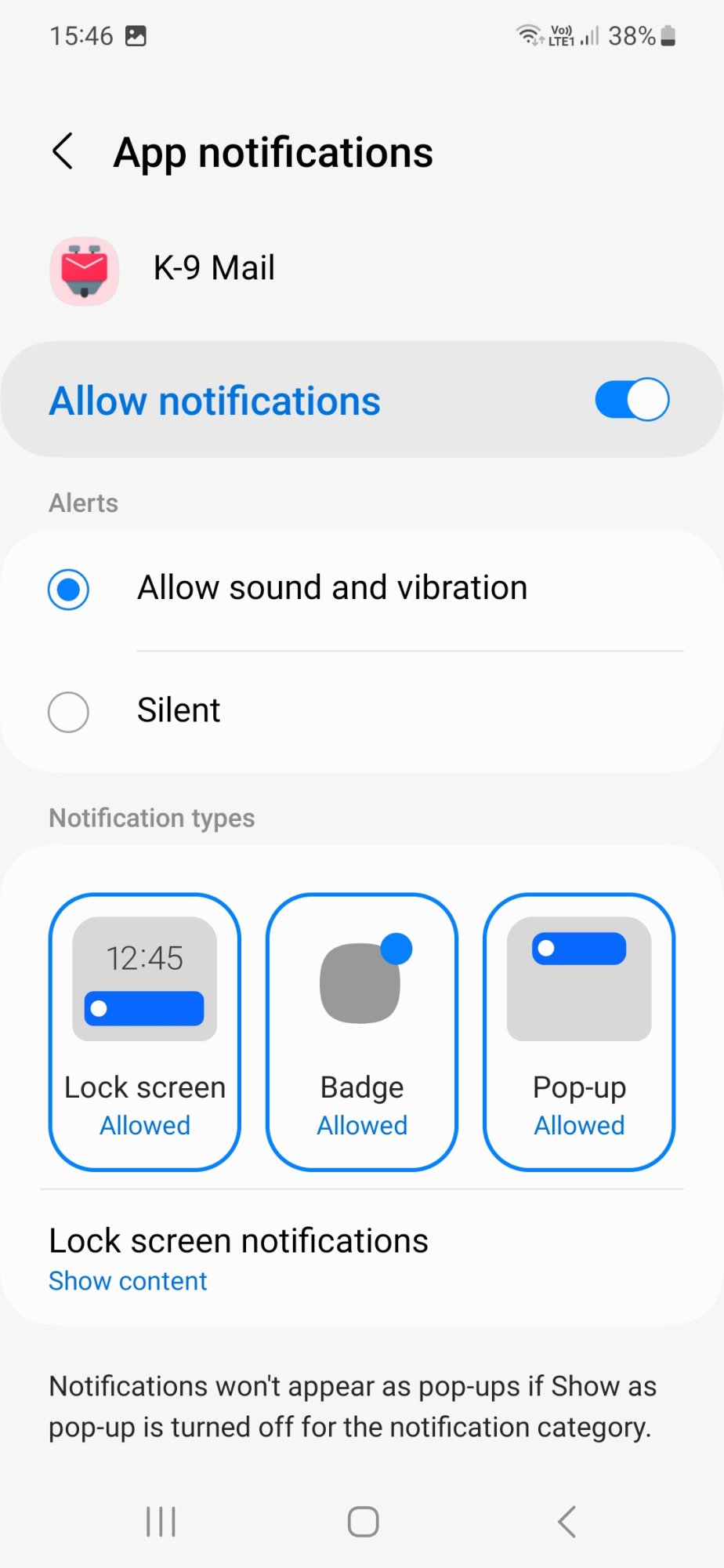

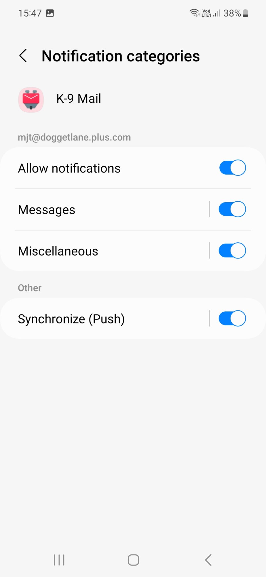

The thing that's annoying me most at the moment is that somehow the use of Bluetooth with my aids has corrupted the alerts of my email client so it no longer works with Bluetooth turned off.
I still can't get notifications back on the email client. All settings look correct, see attached screenshots, and I've even tried toggling each of them off and on to see if that will reset something.
I've now emailed the aid manufacturer to see whether they're aware of the overall problem. I'll report back when/if I get a response.
Edit: Since this post I have had alerts from K-9 on receipt of messages but it still doesn't do it every time. I'm still investigating that.
