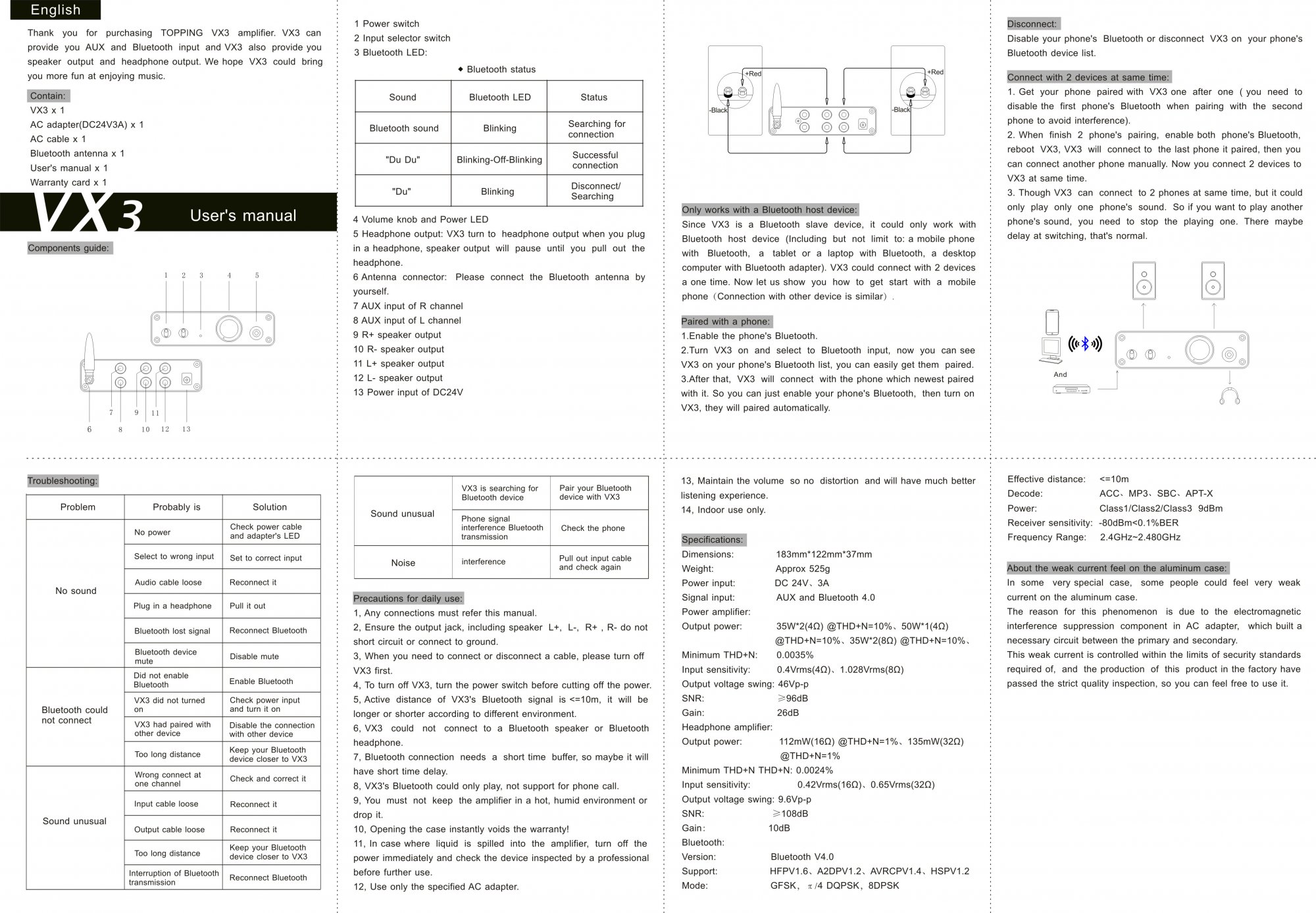

Thanks for your response. I attach a copy of the Topping VX3 "user manual". On checking my Lenovo phone I am told it's Android version is 8.1.0. and the Alldocube tablet is running Android 11. The BRZHIFI PA-04 is supplied with the CSR8675 Bluetooth device.
That seems ok. In the Developer settings BT options are you actually seeing aptX as an option on the phone or the tablet?
I've got a Samsung Galaxy Note20 Ultra with Android 11 and that can connect to my Sony WH-1000XM3 headphones with aptX, as well as LDAC, AAC and SBC. But other BT devices I've got, the aptX and LDAC options are shaded/disabled, because those devices don't support them.

I think Topping are a genuine company and the user guide for the VX3 amplifier states that it supports aptX, and I believe Lenovo can be considered to be a reputable company so why doesn't my Lenove K5 pro running Android 8.1 connect to my Topping VX3 with anything other than SBC or AAC?
Lenovo are certainly a well-known reputable global company, and I'm sure your phone is OK. But as for Topping, they're just one of hundreds of manufacturers of these things in Guangdong Province, that only sells online from China. So it really wouldn't surprise me if their product specs and claims are inaccurate. I live in China, and I'm quire familiar with how things can be here, especially with some tech products. Maybe a reason why I have a Samsung phone, used with Sony and Bose headphones.
In theory, and given the stated specs, these BT amps should support aptX with your phone and tablet. Maybe try contacting Topping, and see if they can suggest anything?
