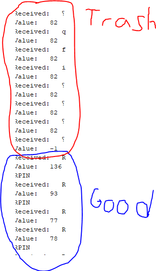

I am trying to make a control board for a rgbw light that is controlled with my phone over bluetooth. My problem now it that if I move the slider to fast I get garbage data on the output (I included a picture of good and garbage data). My thought was to have it send a bulk data set of the position of all 4 sliders at a scheduled interval to keep it from going to fast. I have looked online but I can't find a way to do it that I understand.
How I have it setup now is I have a touch listener setup on a Slider so every time the slider is moved it grabs the position and sends it.
Code:
SliderR.setOnTouchListener(new View.OnTouchListener() {
            @Override
            public boolean onTouch(View view, MotionEvent motionEvent) {
                GetR();        //method to get position of R
                RValue1.setText(Short.toString(Rpos));
                return false;
Code:
private void GetR(){
        Rpos = (short) SliderR.getProgress();
        if (btSocket!=null)
            try
                btSocket.getOutputStream().write("R".getBytes());
                btSocket.getOutputStream().write(Rpos);
            catch (IOException e)
                msg( "Error");
If you could point me in the right direction to what is should be looking for that would be greatly appreciated.
