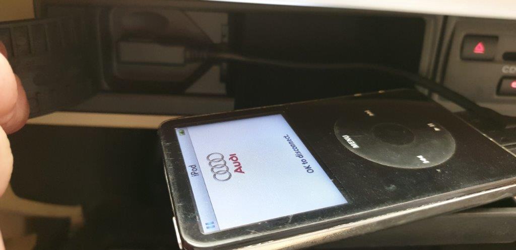

OK, I suspect the MMI upgrade might not be the problem, because I am not sure if the music I was listening to was coming from my phone, or from my car's media player. The car came with it's own dedicated cable that connects it to my (now obsolete) iPod), here it is:
I asked the dealer if he can order a new dedicated Audi cable with a USB C plug so I could connect it with the Galaxy S9, however this is no solution because I will need to plug in the phone every time I get in the car. He was not able to suggest a solution except that my 12 year old car might not be compatible to plasy music as well from a new tech phone, because of limited Mega or Gigabyte capacity (whatever that means....). I mam located in Greece so I don't expect them to solve high-tech phone issues.

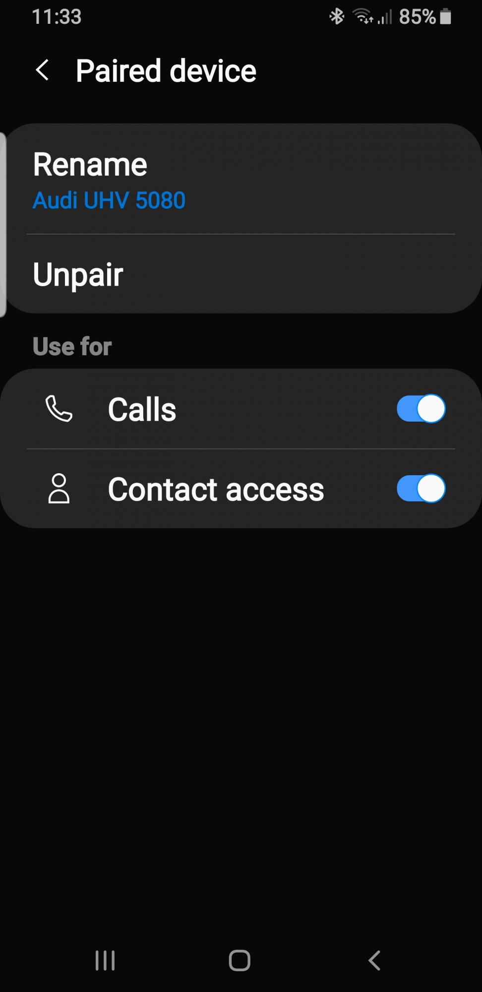

Here is a picture of my phone's Bluetooth connection with the car, no music button there
So on that and going by the screen-shot you posted, it sounds like your 2007 Audi system has never supported BT Media Audio. Specifically the Bluetooth A2DP profile, that is for HQ stereo music streaming. Really the only fix for that is to buy a new head-unit, or use a third-party transmitter solution.
I've still got one of them in the drawer, a 60GB 5th generation iPod. Originally bought in 2007, same as your Audi. Thumbs down for Apple's proprietary connectors and tech, especially when they become obsolete. :thumbsdowndroid:

OK, a third party transmitter is probably the way to go. Now here is what i think:
My Audi is equipped with the factory installed Music Interface MEDIA IN option, because that is where my iPod is connected now with the iPod dedicated cable. It fully connects it to the Audi audio under the 'Media' Source and it brings up on the car screen the detailed iPod's music with playlists, etc
I found on line that I can buy a similar cable, that instead of the iPod plug, comes with micro USB male socket.
If I can find a Third Party Bluetooth transmitter that can connect to the Micro USB, then that might be it!!!!!
What do you guys think? Any suggestions for such a Bluetooth transmitter?????

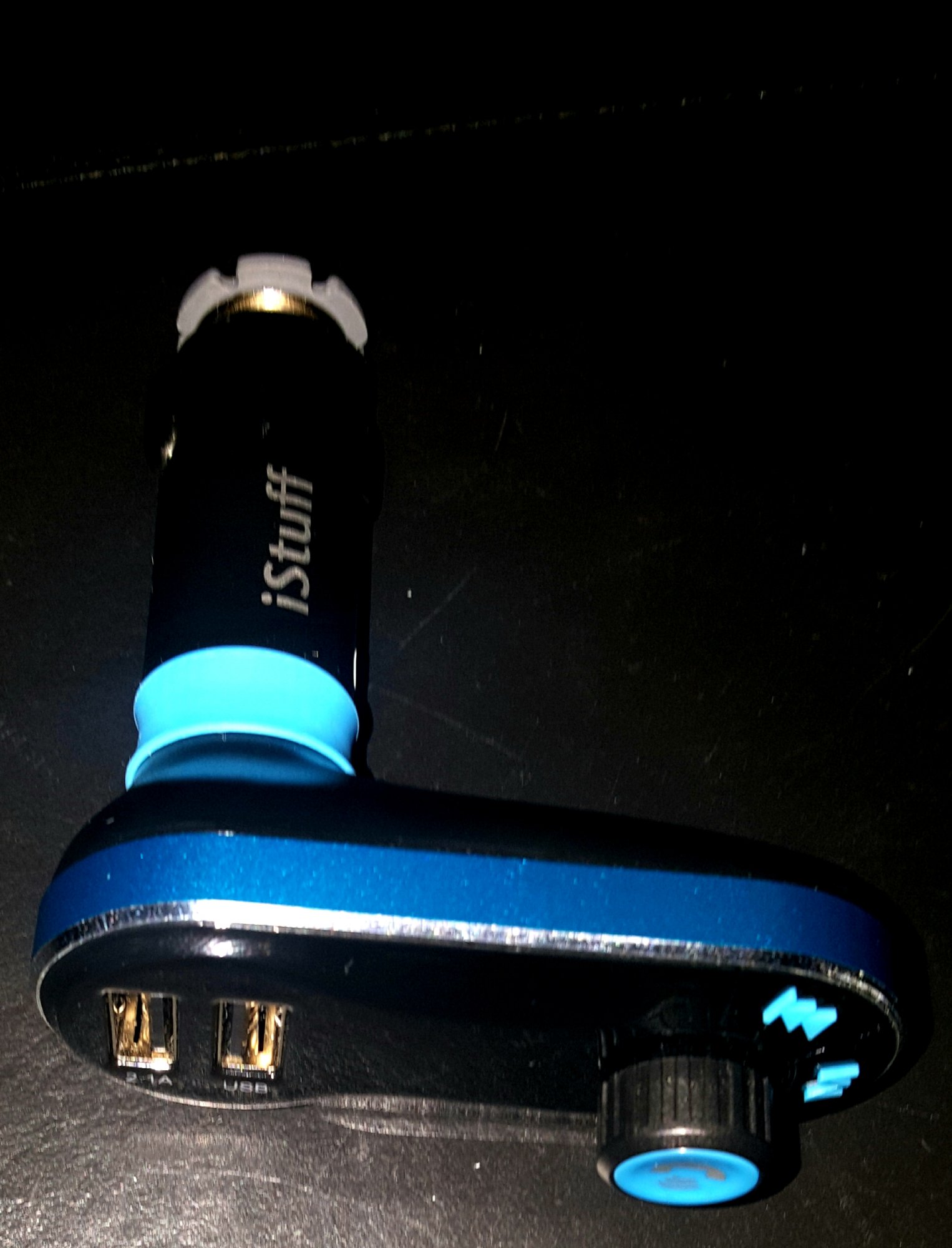

Sorry it took me a minute to share the picture of the Bluetooth transmitter you were asking me about, bro..

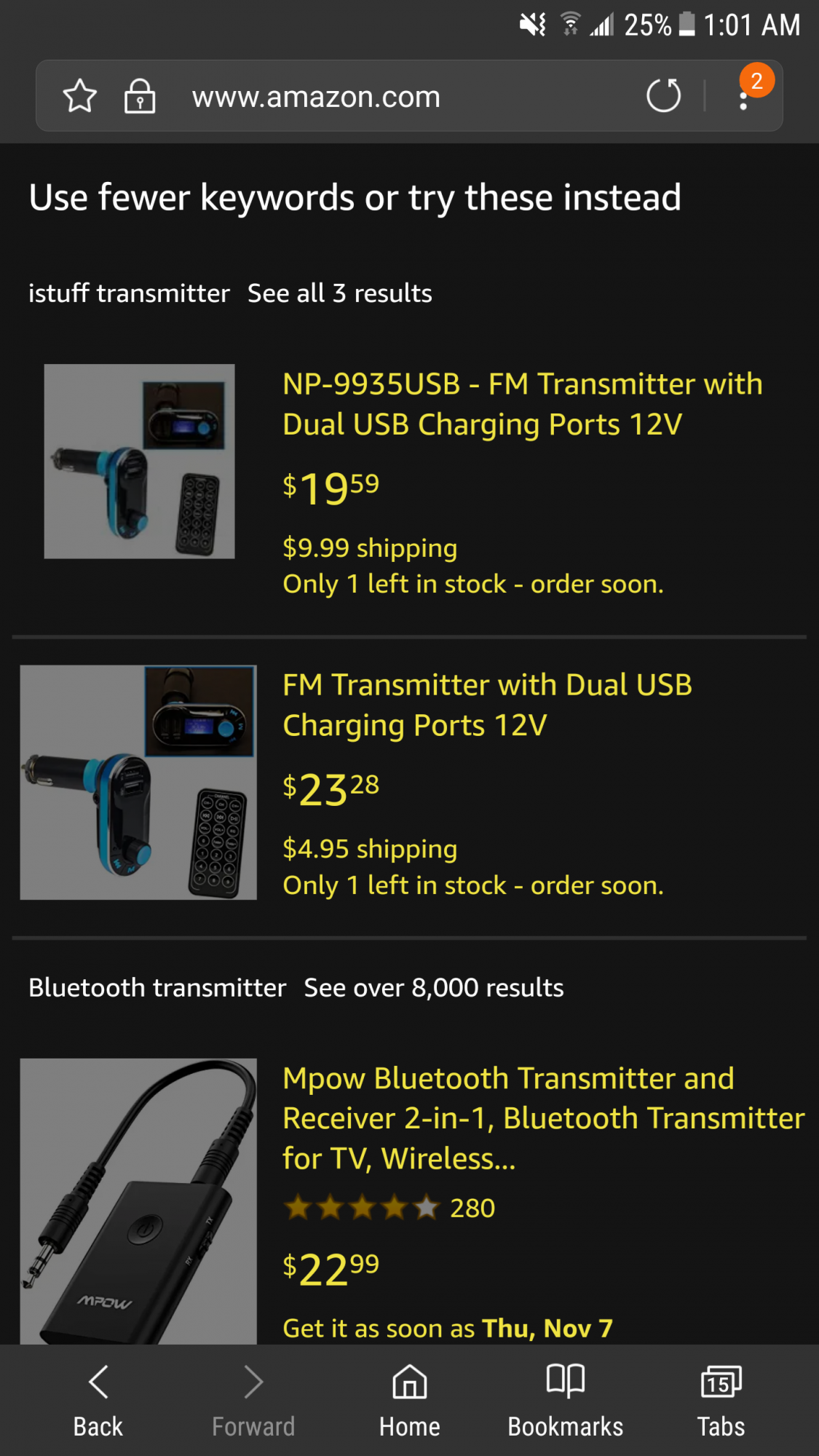

In fact I just learned I paid $20 more else where that what it is in Amazon..oh well done times you lose some times you score..
Thanks Xavier! I see you have an FM transmitter and you are quite happy with it. I just ordered the Audi music interface plug, and I found one with the standard USB female end (not the micro).
So in my case I believe a USB transmitter that will plug right into it will do the job, I'm currently googling for it, but with so many out there I'm still at it..
