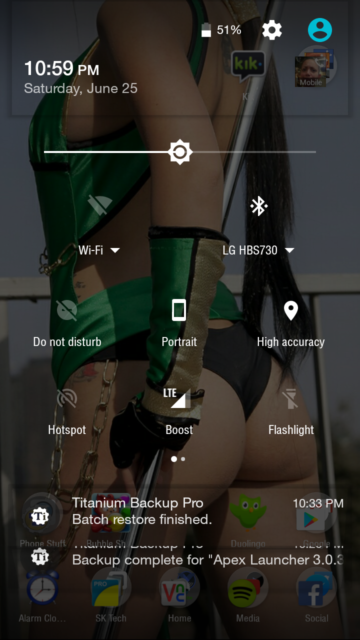

5) Reboot, until you get the home screen. Going into data settings, you should be able to get 3G, but selecting LTE will give you jack squat.
6) Power off, then boot back into recovery.
7) DO NOT WIPE at this point. Flash the ROM (ur so dirty), the GApps, and Slayer together (queue all 3 zips if ya want), reboot.
8) Your pull-down notification bar thingy for data should say Sprint. Thats coo, but waddabout Boost? Make sure your WIFI is off, then go to Settings, About Phone, Status, SIM Status, and check it out. After just viewing this screen, everything should say boost now, and you'll have your LTE.
