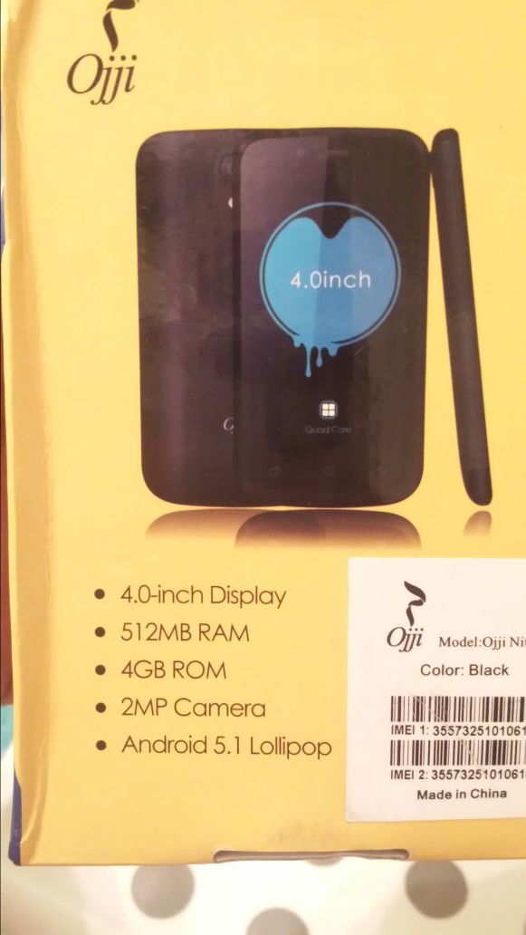

Help build.prop delete
I do not have a backup nandroid, I believe that in the internal memory there is a copy of the file build.prop
the cell phone is ojji nitro

You have an off brand device, so unless we can find someone who can copy their build prop or you find firmware online, I think you may be out of luck, sorry. :(
The root was with kingo, I do not have custom recovery and if I can access fastboot.
it has to be the same model to install a ROM? because I found one of ojji maxx
