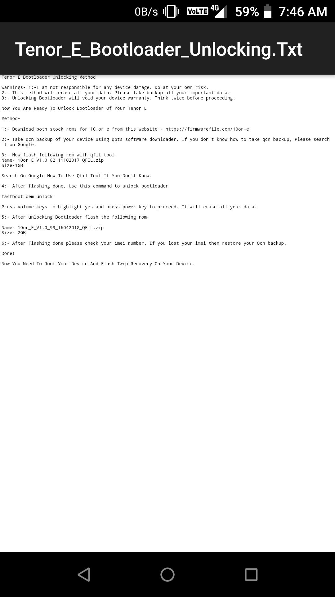

Sir as you said that you are no sure that if flashing stock rom or downgrading in other words will work or not, I was just going through some articles and i found this. Can you please check this out, just read it once sir.
I can't confirm any of that. As I said, I don't have any direct experience with that phone. If you want to try it, then just be aware that you are assuming all the risk with the possibility of the process simply doesn't work up to completely bricking your phone. It could work, but I don't know one way or another.
