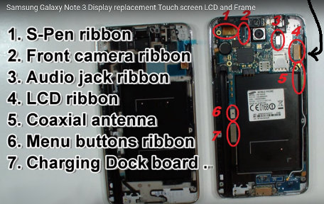

This is more of an alternative suggestion to your query but depending on just how your Note display is 'broken' there could be a chance that it's still functional but the problem is the ribbon connector between the motherboard and the display itself has become loosened. If the phone still makes its usual startup sounds when booting it up and it's only the display that isn't responsive at all, it might be worth the time to try and re-seat the press-fit connector to resurrect your phone. (See #4 as indicated in the attached jpg.)
Detailed instructions on disassembling your Note can be found here on ifixit's site:
https://www.ifixit.com/Guide/Samsung+Galaxy+Note+3+Display+Assembly+Replacement/31020
(see step 8, 2nd photo specifically)
Luckily Samsung still relied on mostly mechanical fasteners with this model, for a lot of phones now all the internal components are fused together with glues and adhesives.
