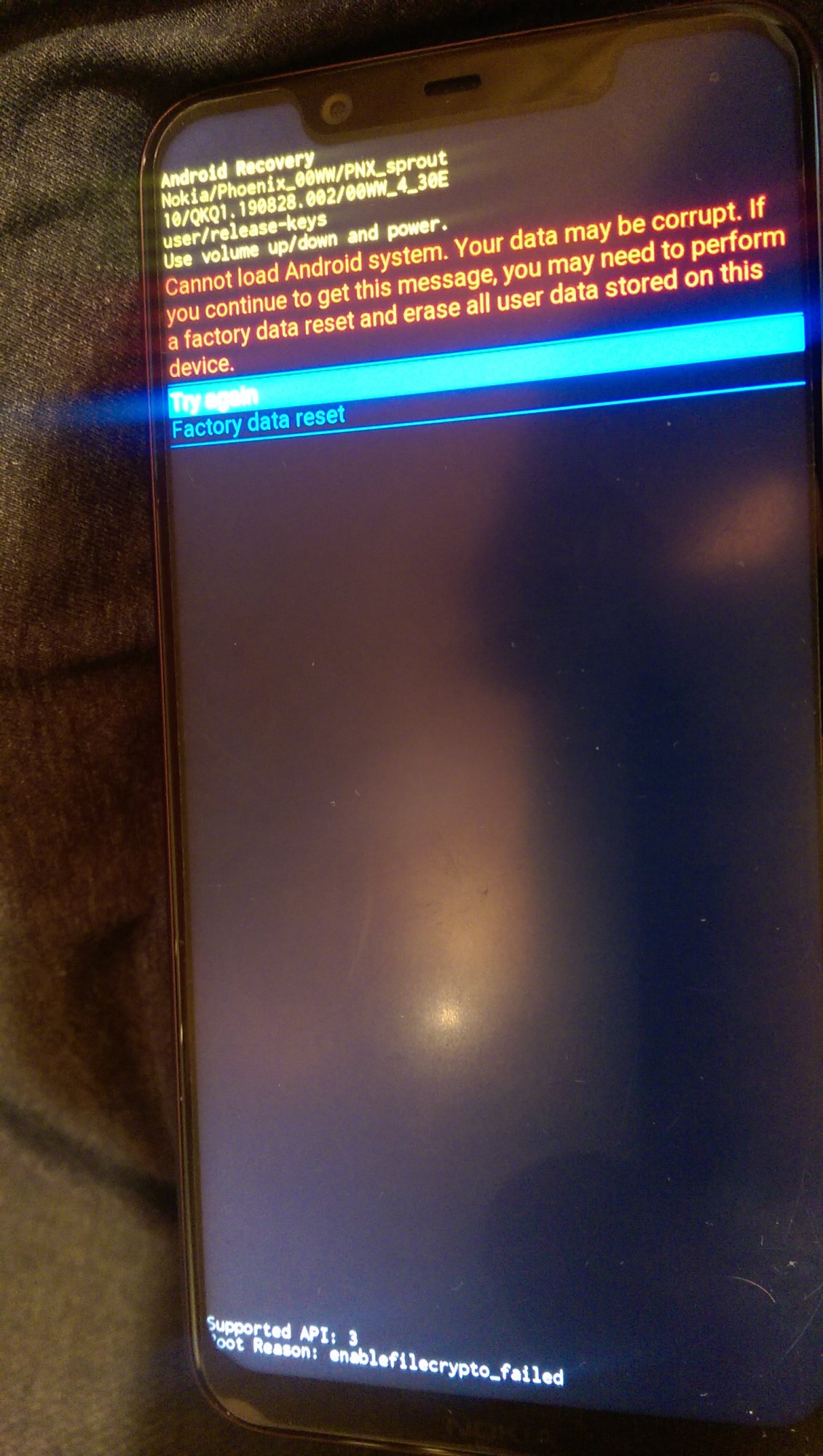

See attachment.
No matter how many times I restart I get the same message. That's where I am at today. Stuck there.

Android data corrupt means just that. Your installation is gone. Even if you could get the phone to boot again, you would have to either reset or reflash it, which will generate a new encryption key rendering any data unusable. My guess would be that the salt water gradually made it's way into the phone through the charging port until it shorted out just enough to corrupt your data. I'd look for an online backup as your only possibility. Sorry

If the Android data is corrupt, could it be that doing this funny thing could get the os going again?
I was thinking perhaps vital parts of the os is corrupt, enough to make it un-bootable, but perhaps only parts of the media is corrupt, so some of it might be salvageable? Just as long as I get a os update thru cable.
The strange thing is that the phone worked perfectly fine from 18.00 (when it got wet) until 03.00. So everything worked for nine hours after getting wet, only problem was that I couldn't charge it. I couldn't charge it, and when the battery got flat the funny "Android system" couldn't load message came. And I'm stuck there.
Unfortunately the partitions are virtual so as soon as the os is restored the data partitions are rebuilt. Even if you could get the os restored the system would generate a new encryption key so any data found would not be recoverable.
I have to click like on that, lunatic59, even though it's sad. I was hoping it would be easier to fix this than what's discussed on XDA, cuz it could be corrotion related, but sadly it's not.
The XDA thread is speaking directly to an error that happens following an update. I suspect the update confused the system as to which was actually the user data partition. Yours I believe to be real physical damage to the chips/circuits, so this 'fix' won't help you. The fact that the error message was the same is just coincidental. It's where the Android bootloader takes you when there is a problem with the file/partition structure. It would be analogous to having a car that will crank but won't start. It could be that you are out of gas, a spark plug wire came off or your head was blown. But, if your head was blown, putting gas in it won't make it go.

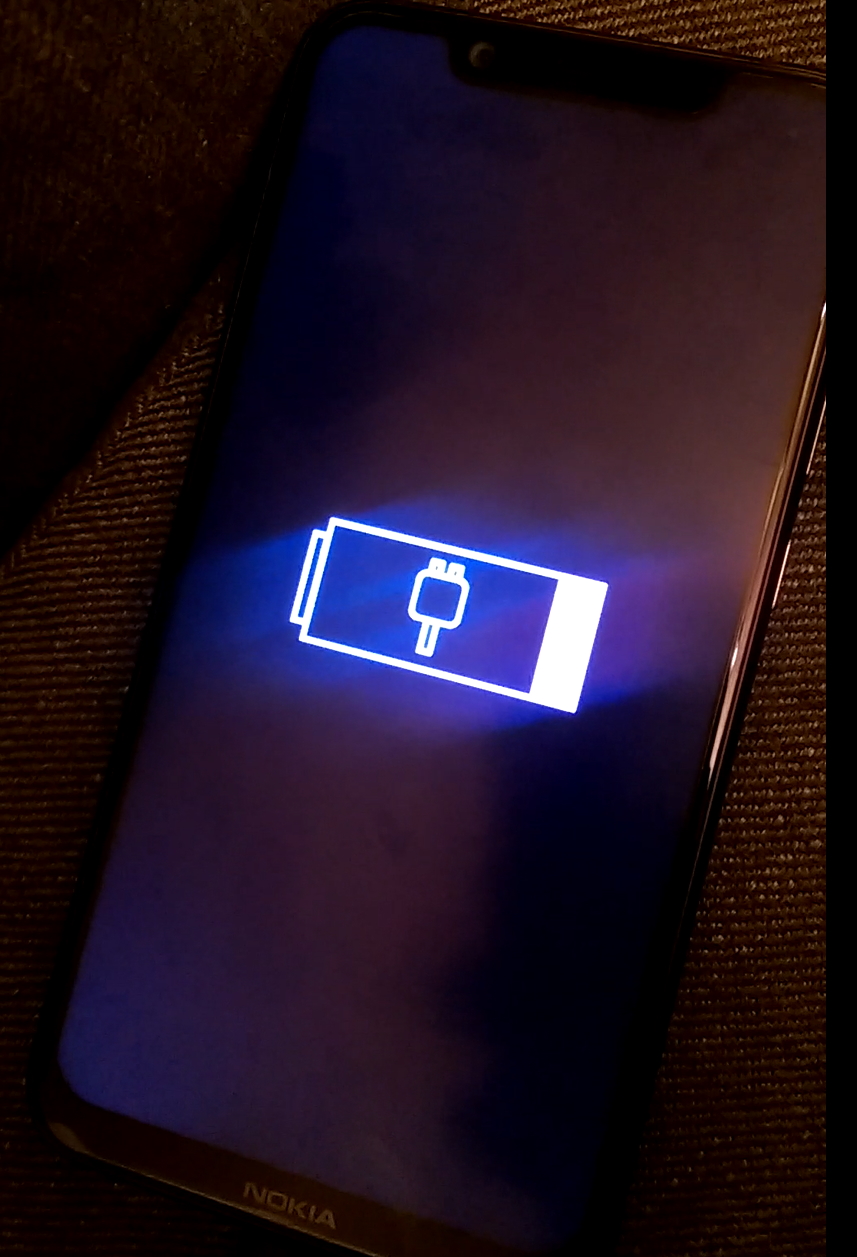

Every time I boot, before getting the Android system error, it says the phone has zero power. That's even though I charged it for eight hours, using two chargers.
Some say never ever let your battery get completely flat. I got my battery completely flat. I know the phone's charge port malfunctioned shortly after salt water exposure, I know the phone worked fine until the battery was flat, so ... could it be replacing the battery would be of any help?
I dunno if complete power shortage theoretically can cause the 'Android system' booting problems.
Yes, that could be a valid scenario. If the battery is damaged and falsely reports it's output voltage it "could" cause a boot problem like this, but it's not guarantee. I see replacement batteries for Nokia 7.1 phones on eBay for around $20 so it's worth a shot. I'm not sure what's involved in replacing a battery on this phone, but if it's anything like recent Samsungs, take your time and be VERY gentle or you could cause additional damage.
