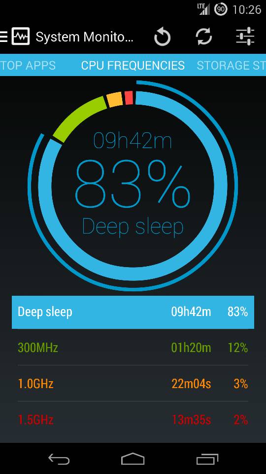

Underclocking is only going to be beneficial when the phone tries to use a higher CPU frequency.
IE if your CPU max is 1728 MHz but with your "normal use" the cpu would only go above that 0.1% of the time, you're not going to see any tangible difference in battery life.
So without seeing how long your CPU stayed in each frequency its hard to tell if underclocking is going to be beneficial to you.
You can check the times in any number of apps
Here's fku:
In that example, my phone never went above 1.5 in the last ~11 hours (I am not underclocked). Therefore Underclocking to 1.7 wouldnt have any effect, but going below 1.5 would slow my clock speeds down 2% of the time, which still may not be noticeable on battery life.
Note those numbers include 9 hours or so of me sleeping (and also the device). Don't take these numbers too far, they're just used as an example. If you pull out the deep sleep time, 1.5 is a much larger percent (11%). Your use patterns will determine what works
One more thing to note is your device was held awake for 3 hours. I would look further into that. If you were listening to music or something than thats no big deal, but if an app held your device awake for that time when it didn't need to you're going to take a hit on battery life
Here's fku:
Good points, is that when under volting could potentially improve battery life? I'll have a look at my time in each state at the end of this charge cycle, see how it looks :)
