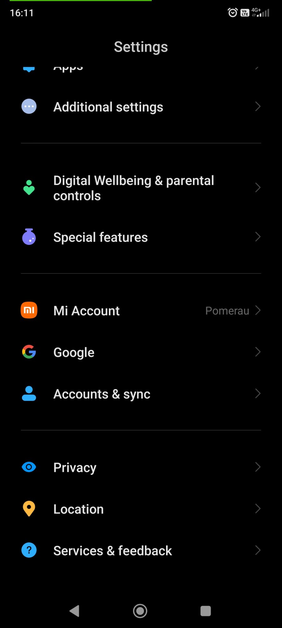

If you have your Xiaomi account number showing, you can use the Xiaomi Community Forum app to raise a question - though that may not have downloaded or updated from the former Mi Community app.

In fact, as well as the Forum app, or instead of, better to use the Services and Feedback at the Bottom of the Settings screen and submit a Feedback question, as I did in February.

Screenshot_2022-10-22-16-00-15-365_com.miui.bugreport.jpg Screenshot_2022-10-22-16-00-46-099_com.miui.bugreport.jpg IMG_20221015_184243.jpg Screenshot_2022-10-15-18-41-29-356_com.miui.gallery.jpg
Also add Logs via the Logs button.

I had the same issue. Make sure you are logged off with the Google user. Log in to Mi account by entering your google user, not by signing in with Google user. After you succeed to log in to Mi account, the Google account appears as signed in :)

Where do I log in to Mi Account?
