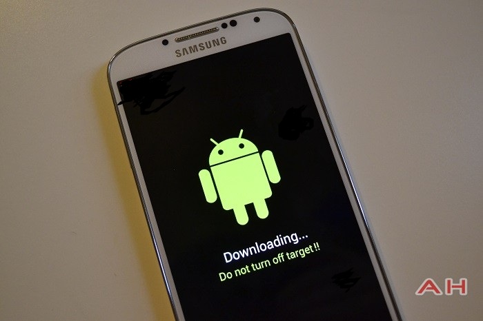

Everything seem to work fine, until I'm trying Manually reboot the phone into recovery mode, the newly teamwin recovery( (Flashed with heimdall ), when I try that (holding vol up+powr+home in the download mode after flashing the new recovery mode) it gets me to "downloading do not turn off target" screen. if I reboot and try again the "vol up+powr+home", this time it gets me to the stock rom recovery.

Again, i'm in the "downloading... Do not turn off target!!"

Booting into recovery from off, volume up + home + power should take you to recovery. Strange that it is taking you back to download mode.
Its not the Odin "download mode" its just this screen (see uploaded file)

If the recovery is successfully transferred, step #8 in the link, and you follow 9&10, it should work. Don't know why it won't boot into recovery. The no reboot command is in step 7.
Only thing I can think of is maybe bad download of the .img file. You could delete the one you have and try a different download.

Well it works now, you were right maybe the img file was bad download.
