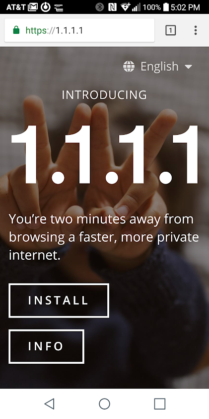

Is this the ad you're getting?
That's what I get when i try to go to that URL on mobile data ... so try this next time. Before you connect to the guest network, go to settings>wifi>menu (three dots upper right)>advanced and make sure "Switch to mobile data when data when internet unavailable via wifi" is OFF.
I think what's happening is when you connect to the guest wifi you get the redirect too late to establish an internet connection before it switches back to mobile data, and then it tries to resolve that IP via the internet instead of the captive portal system.

That is the ad I see. Good to know it's kosher, even if it's really, really irritating that it causes these issues.
