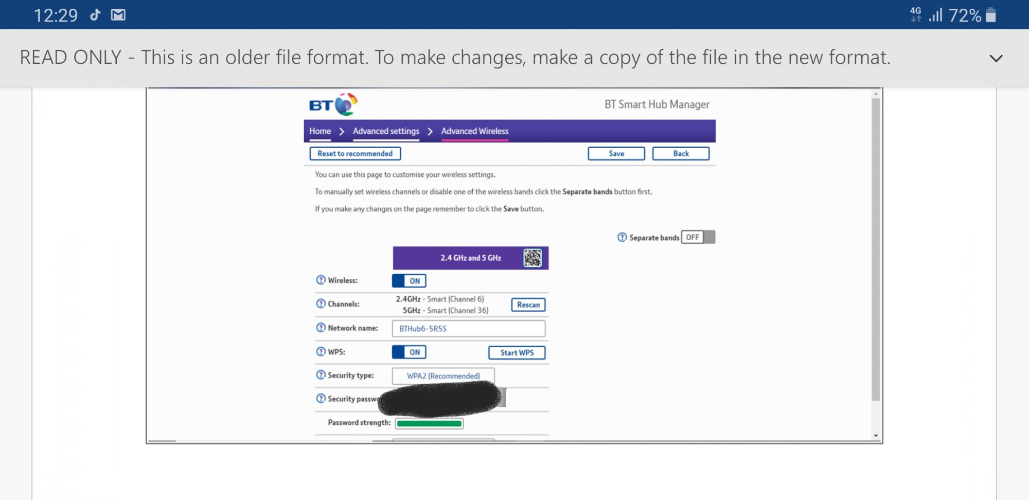

Followed the link into Hub manager and I have attached a screenshot of the hub manager screen.

Does not give me the option to do items 5, 6 , 7 and 8
The router is a BT Smart Hub
Can you not click the Separate bands button Brian? Also, your doc shows a little too much info Brain I suggest you remove the attachment.
I deleted your attachment Brian. It contained a password, and since @JAy3001 has uploaded a screenshot with the password blanked out, we should be good.

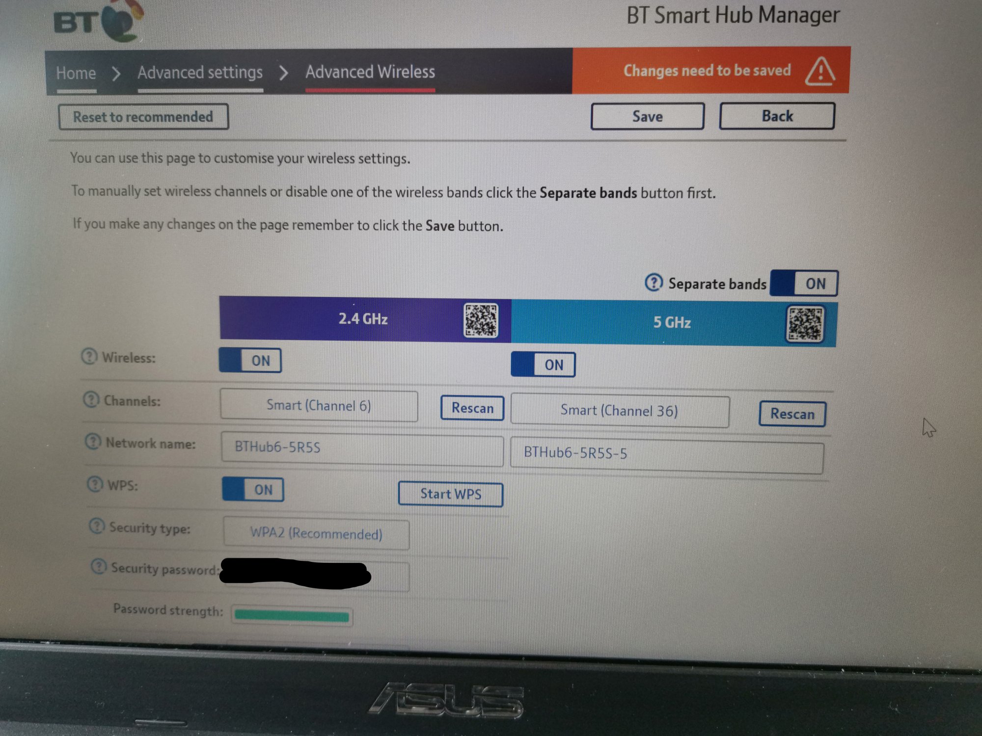

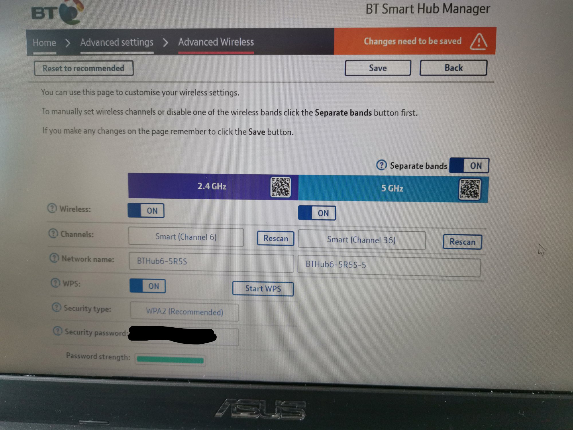

Hi Brain. Sorry but the attachment is not working for me, I just see the blanked out line and nothing else. Could you not take a picture with your phone and upload instead?
All looks good to me Brain. What is the current issue? Did you save these changes and can you see the new broadcasting SSID of:
BTHub6-5R5S
on your old phone? The password will be the same as your 5GHZ channel.
Hasn't changed. Can't see either of the broadcasting SSID's. Also, new problem, my printer can't connect wirelessly either as it cannot detect the SSID's either.
Brian
  • Double check the SSID have not accidentally been switched to the off position and that your changes are active.
  • Try switching the router off for a minute or so. When it's back up and running login and see if your changes are still active ie split channels.
  • Now scan on your devices to see if the SSID are broadcasting.
Checked SSID and it has not switched off. Switched off router and rebooted, Changes have been saved.
