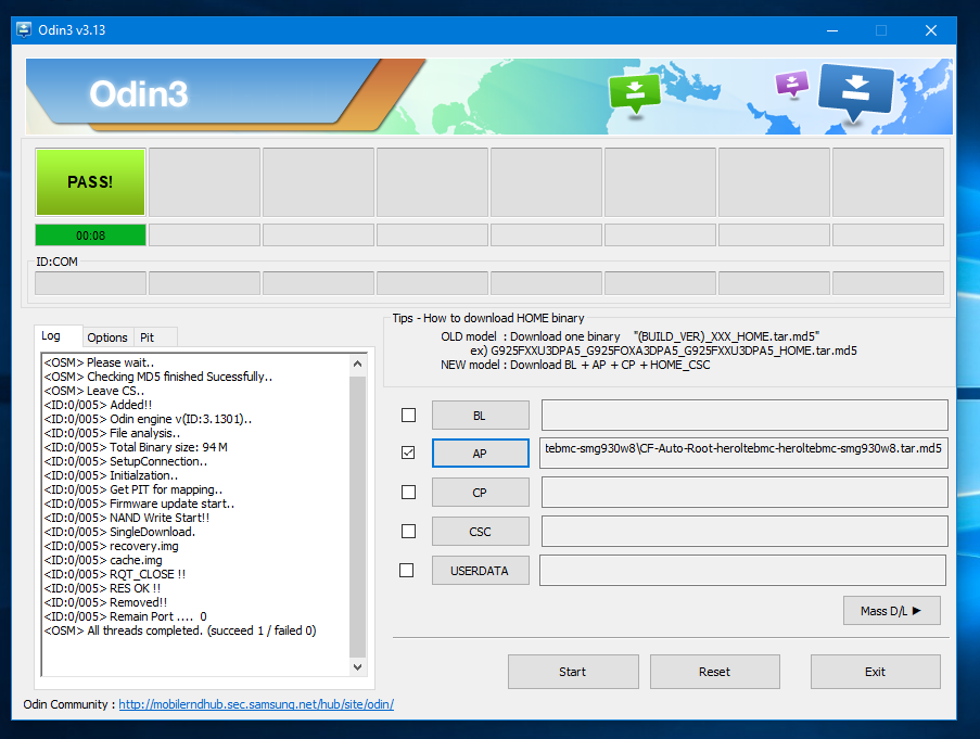

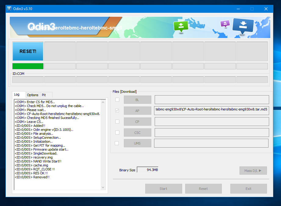

When I try to root my Samsung galaxy S7 with Odin it says "Reset" and not "Pass" like it is supposed to. I'v tried downloading the correct root file from a few different sources and still wont work. I also tried RootGenius. I want to root it to remove built in apps that I don't need, like the Rogers app, Rogers NHL (no Idea why they are on there as it is unlocked and never with rogers I don't think.), Facebook, Whats app etc. They are just taking up space that I could be using for other stuff.
Any ideas why it wont work??

Do you have a link to a guide that you are following?
In the link to the root method I mentioned in my second post, Odin also shows Reset instead of Pass, but there is steps you need to take immediately after as in Step 13 of the link.
Was there anything you did different?

Okay So when I rooted it before, I then unrooted it when I was done. Now I tried to root it again and it failed! Now it is in a boot loop and tries to "install system update" but then fails and says "no command" I can't even flash the firmware on it again, When I try, in Odin it is stuck at "set partition". I Can't get it to work. HEEELLP!!
