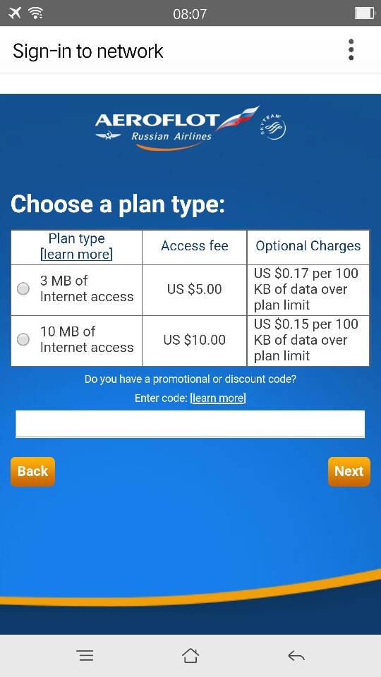

Yeh you can use the phone's WiFi in flight mode, here's my proof from previous screen-shot...
I've never known a device that can't, and can use Bluetooth as well while it's in flight mode.

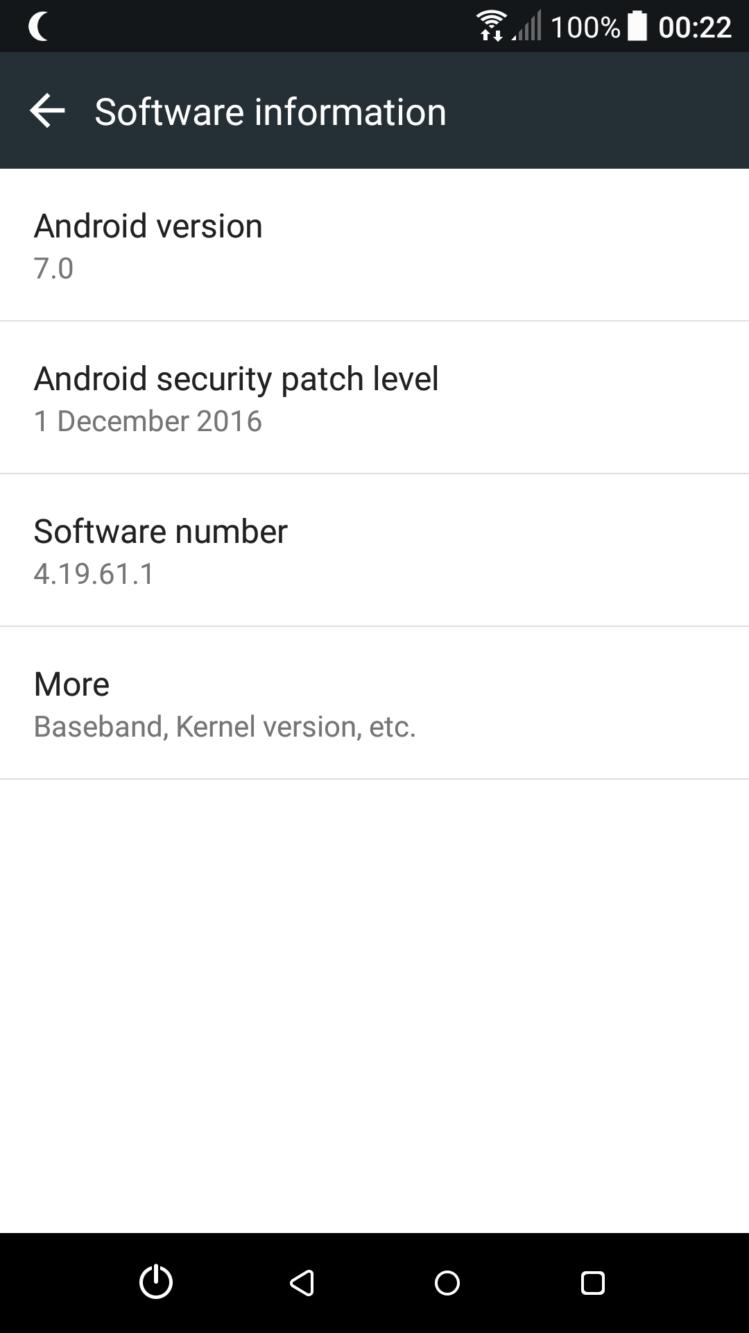

I have an M9 running Android 7. With Airplane mode on I can switch WiFi on.
As a matter of interest I can also switch Bluetooth on but not Mobile data.

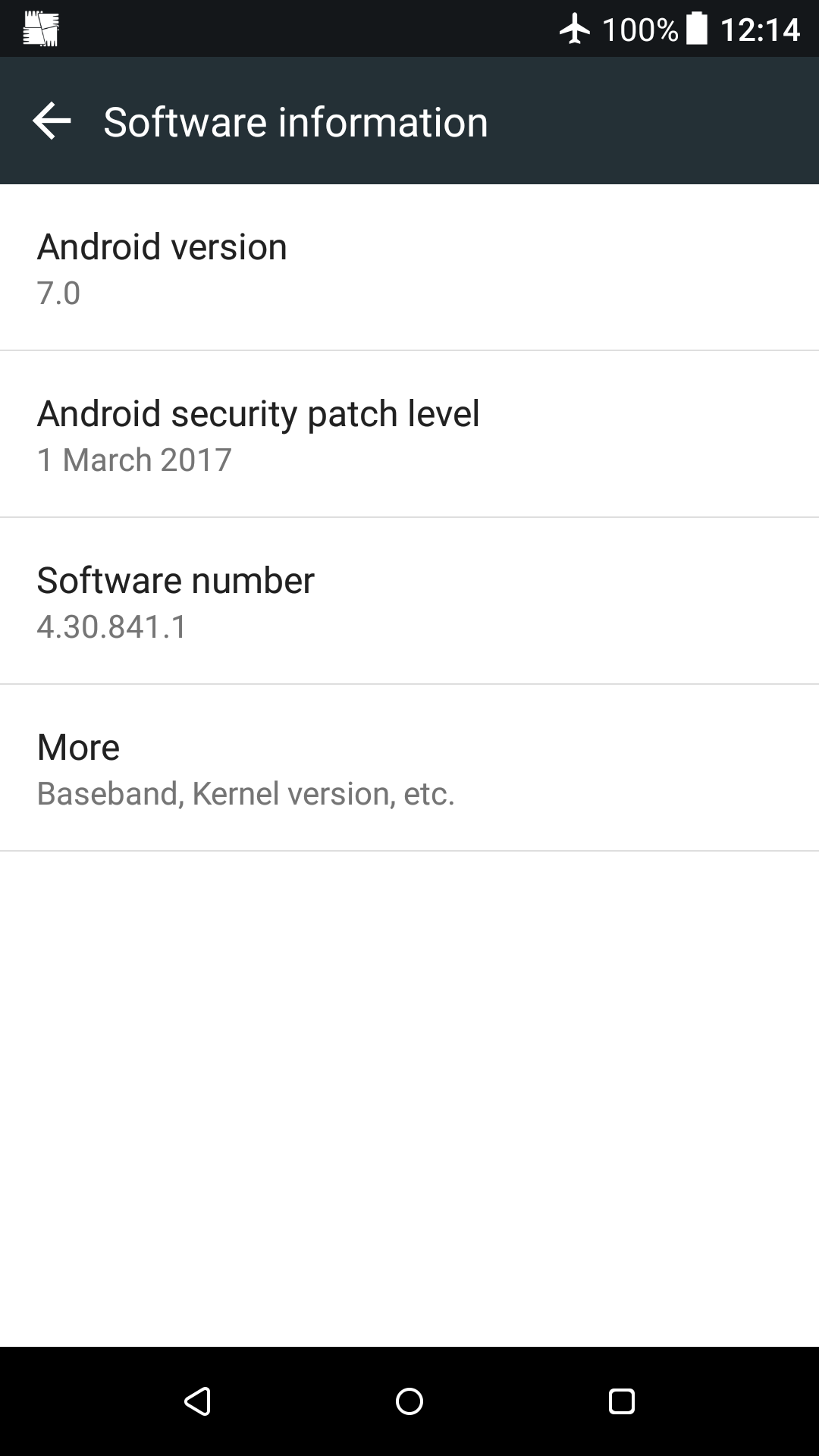

I have a more updated software so I am guessing it's the actual phone even though HTC said it was the software that doesn't allow you to be on wireless in flight mode
