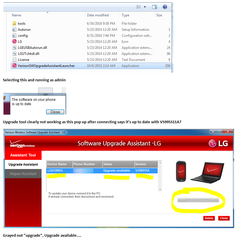

Anyway, Retha had me try a new feature in which you're suppose to connect the V20 to a PC and downloadthe VZW software update tool to update or repair the phone. In my case the button to do either was grayed out and not accessible.
Putting that PC into safe mode or turning off all security measures changed nothing!
Phone had to be in "file transfer" mode, dragging the notification bar down and changing to "charge only".

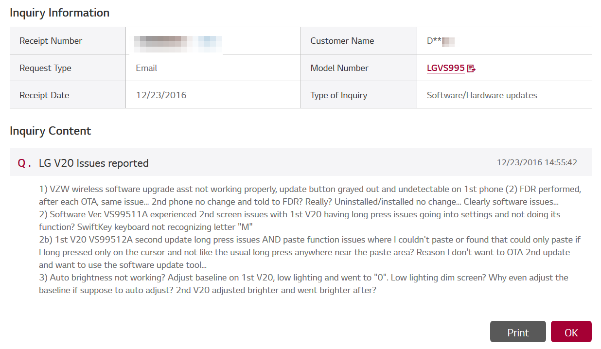

I have contacted LG and reported all of my current findings, to include the second V20 and was told to FDR the phone and if it still persists to send it in... At this point I told LG in a feedback email that the issue lies within the phone if (2) of them are identically doing the same flaw...

Has anyone tried, if they're with Verizon, the "Verizon Wireless Software Upgrade Assistant?"
http://www.lg.com/us/support/software-firmware-drivers
My only point is whether or not the button to upgrade is grayed out or if it is clickable?
The whole point of this software, according to a Tier 2 tech support at Verizon, is to upgrade your phone software via a PC or MAC and not do it Over the Air (OTA). Apparently OTA, even with a good Wi-Fi signal, can still have issues and someone thought of this tool, but with (2) V20's later it doesn't work? LG when asked about it said to FDR the 2nd V20...
Even after a FDR on the 2nd V20 it didn't make a difference...
Other side note is to communicate with the phone via the USB C cable you need to pull the notification screen down from the top and change the "USB charge only" to either "File Transfer" or "Software Update" to get the PC/MAC to recognize the phone after the software and its drivers install. If you need any help hit me up...
If you have another carrier, use the model number listed under settings/about phone/hardware info or the equivalent to get the info. For the above Verizon the model number is VS995 for the V20 and under software update and below it will show "software update tool".
I've attached a copy of what I sent to LG feedback and a copy of what the Verizon software update tool looks like and the visual of what I was describing...

I ordered a second V20 through Costco, since they have a 90 day return window and was told by the kiosk lady that they give you 30 days to return the original phone before they charge full price. Anyway, the 2nd V20 shows the same 2nd screen long press issues with a tap of the screen. I did an Factory Data Reset (FDR) on the phone for a user error on my part and will post an update to what I find...
