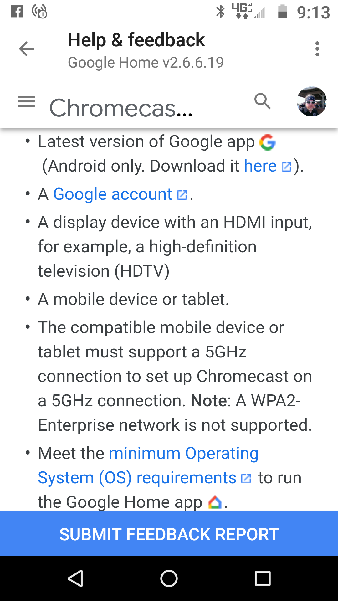

I just gave up when I read about the Chromecast not working with wpa2 or whatever that is.

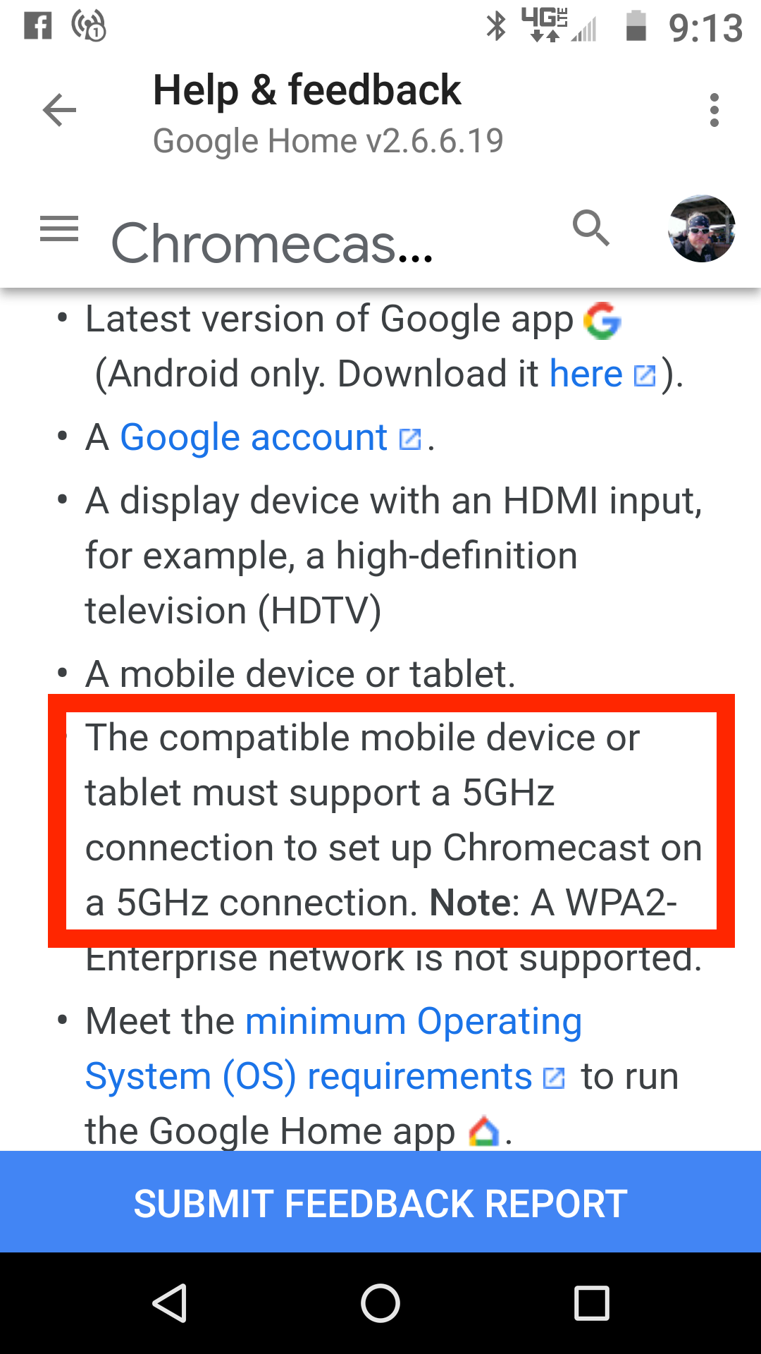

Could be the problem? AFAIK phones do hotspot tethering at 2.4GHz WiFi, and not 5GHz. Chromecast requires a 5GHz connection, because of the bandwidth required for receiving video via WiFi.
Quite frankly if this is the problem, don't know what can be done about that. Except possibly removing the SIM from the phone and using a 4G cellular capable router instead, which supports 5GHz WiFi, rather than phone tethering.
Please post just where you've read that Chromecast doesn't support WPA2, that simply isn't true and whatever source needs to be called out on this.
No, that graphic is highlighting only part of the whole message. Yes a router has to provide a 5GHz WiFi to connect a Chromecast over a 5GHz, but that's in no way an exclusive requirement. A Chromecast can work over either 2.4GHz or 5GHz band. Regarding bandwidth, even a 3Mbps connection is enough to support standard res video content, a trivial amount for a 2.4GHz WiFi network.

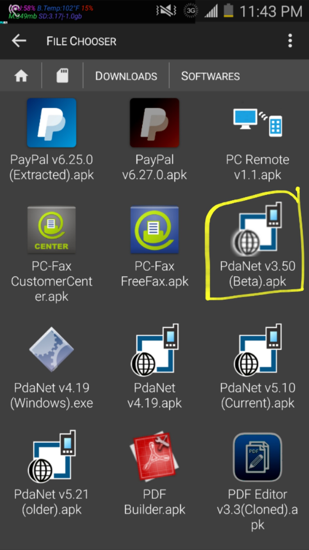

I was thinking, why don't you skip the Chromecast thing and just share your phone data directly to your Wi-Fi tv..I am not into the Chromecast thing nor a professional gig..just bringing ideas to the table..just so you now, the best way to do tether is through PDA Net..what an app invented!!!, and avoid all that hustle..now with this bad boy I can watch Netflix and what ever I want on my pc with zero buffing and lag..and the beauty of it is that instead of Wi-Fi..you can transmit the data from your phone via Bluetooth..wish seems to be harder to detect by your service provider..Bluetooth is very solid

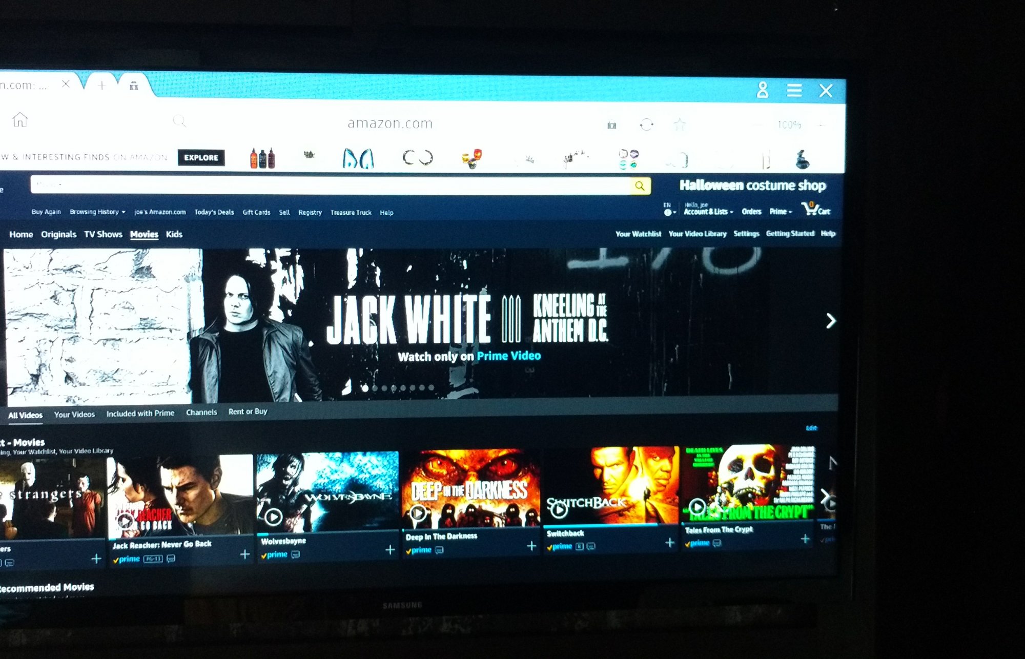

Well......finally in. Had to set the input to TV from HDMI & change the signal from Wi-Fi to my hotspot. Slowest operating system since the 90's.
Looks as though Amazon charges for the free stuff. $2.99 per download. But.....it is what is it.
Thanks guys. One of the responses lead me in this last resort direction.
