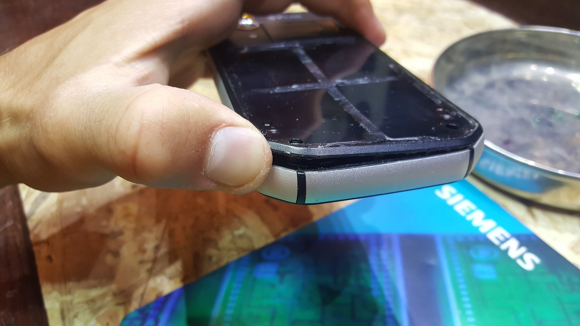

Firs step is to take a sharp scalpel and to remove the back cover with a pattern. It is held with some double sided tape. Be careful around the SIM card slot not to break the back cover.

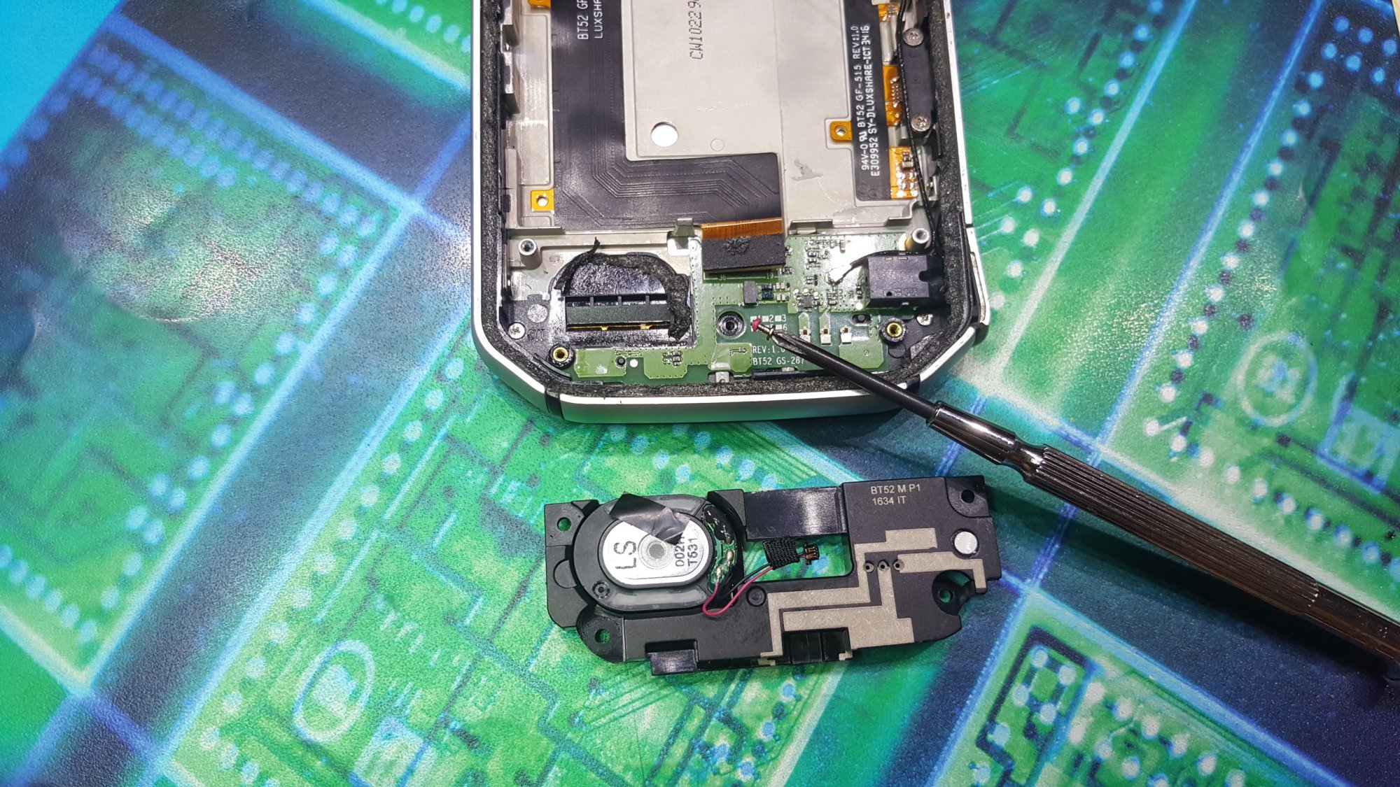

The bottom board with the speaker is held with couple of plastic clips. The speaker is glued with the same "foam glue" as the back cover. There is one screw and couple of connectors that need to be removed to take it all out.

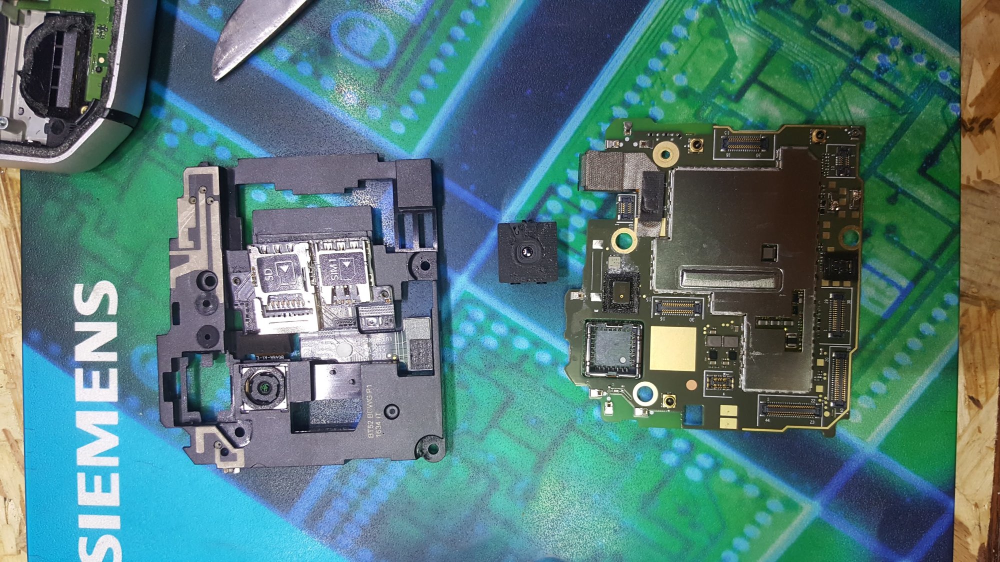

Main board with the cameras, processor and the rest can be taken apart as well. The thermal camera can be taken out from its connector after removing a thin metal cover. SIM car slots, front, back camera as well.
Mine problem was some corrosion on one chip that can be seen on the pictures if you look closely. I managed to clean it with distilled water, contact cleaner and alcohol. I heated it with a hot air soldering station as well to resolder the chip and assembled the phone. After connecting it to a charger the screen started to work again and the phone is back to full functionality.
