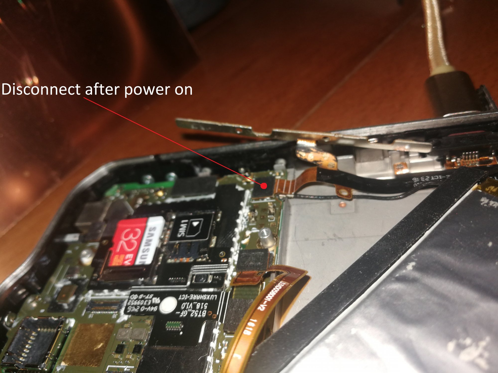

Hi Guys.
After a couple of hours finding the reason why this loop was also happening to my Cat s60, here is what i found out...
The power button gets damaged and creates a short so it will never stop rebooting. It happened to me after a swim foto shot later that day(i don't know if it has anything to do with that but it happened). This is what you can try to see if your problem is the same as mine.
Disassemble the phone and when the phone boots up into the cat logo, disconnect the cable on the attached foto n1. If the phone get out of the loop then you have found your problem.

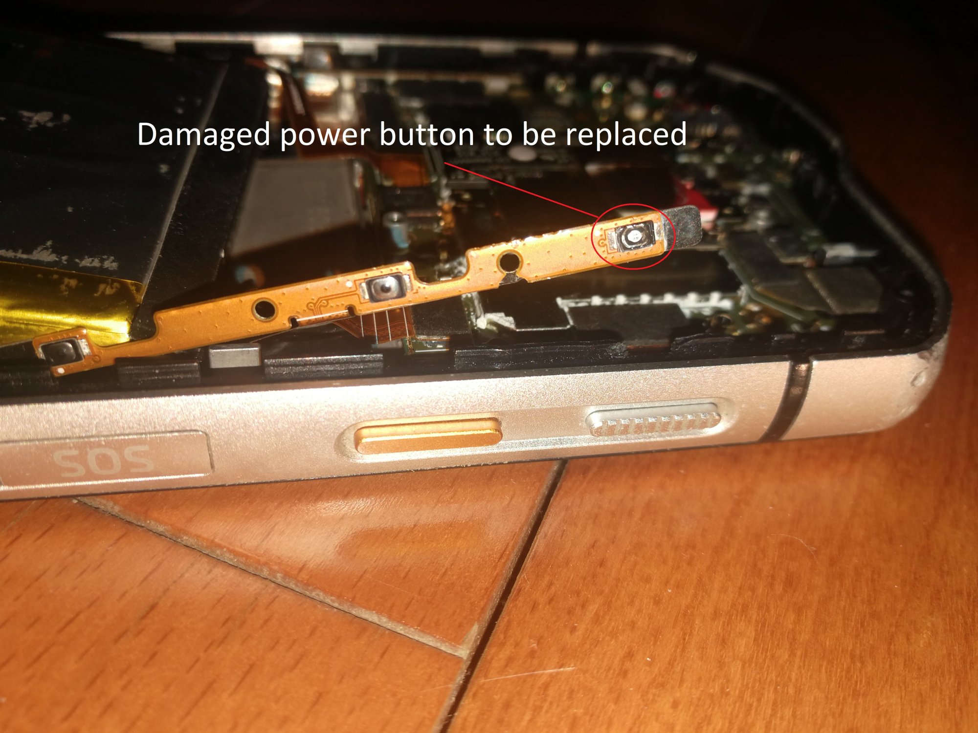

Foto n2 is the damaged button.
I will be replacing the button and post fotos as soon as it is fixed with new modification.

Hi Guys.
