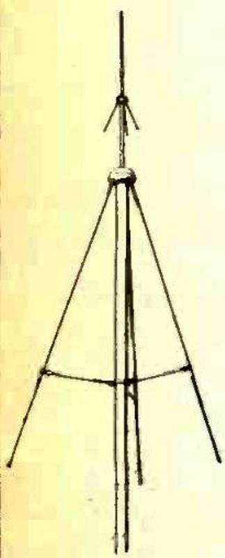

I had a Hi-Gain double side band that was tweaked for power, on a VFO to tune channels with a digital frequency meter and a 100 watt digital linear !
It was technically a CB radio but the VFO allowed me to slide out both sides of the cb meter band.
This is the beam and ground plane :
